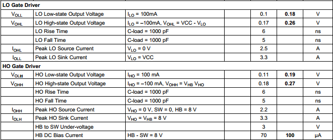

I am trying to find the min, typ, & max levels for the Low side MOSFET gate drive pins (LO1&2) & the High side MOSFET gate drive output pins (HO1&2). Is this equal to the VCC level minus some drop?

Per the datasheet, the absolute max for the LO pins is –0.3 to VCC+0.3 V, and for the HO pins is –0.3 to HB+0.3 V (HB is high-side driver supply for bootstrap gate drive). It is recommended to stay away from the maximum limits in case of any fluctuations; i.e. LO should be kept from 0 to VCC.

Thanks for the reply. I understand the absolute max numbers. What I am after is the voltage level that is driven out of these pins. ie, what will the gate to source voltage be on the external FETs that these pins drive?

I apologize for the confusion. Please see the chart below that I pulled from page 7 of the datasheet. As you can see, during peak LO source and sink currents, VLO ranges from 0 to VCC, and during peak HO source and sink currents, VHO ranges from 0 to VHB.
Does this answer you question?
