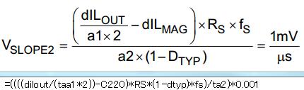

It is different the equation of Vslope2 in Apprication report from in Excel Design Tool.
Which is true?
