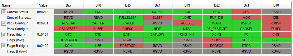

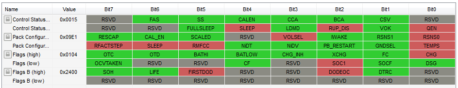

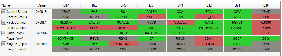

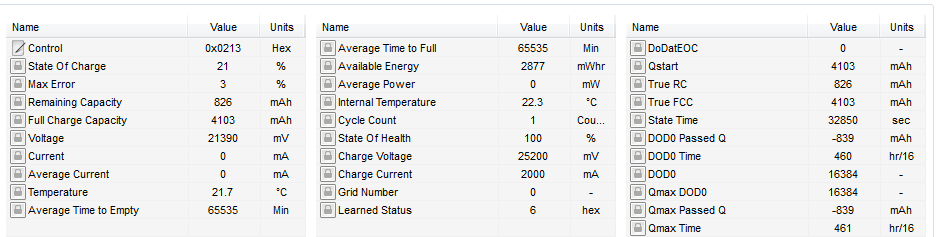

    Were you able to prepare the document? (about learning cycle)
    You say that it is normal to see VOK in green after the learning cycle. But is it normal that stays green all the time?
    On three batteries, after the learning cycle, the maxerror is equal to 3% (so, Ra_Table is not updated). However Update Status = 06. Do you have an explanation?
    Something else. We wish to have Learned Status = 06. But in paragraph 7.3.2.23 of the datasheet: IT is enable and CF1, CF0 = 1, 0. (Case not taken into account).
    After a learning cycle, Learned Status should be equal to 0C or 0D, no ? Qmax updated + IT enable.
    Batt 1
    Batt2
    Batt3
    BR.
  • Charles-Elie,
    It is normal for VOK to clear at some point in the process, but it should also set if everything is working properly. The fact that the Ra table has not updated and RDIS is set, indicates you may not have a good ChemID match. Could you send the log file from the optimization cycle? We can check the ChemID match and why the Ra table is not updating.
    Tom
