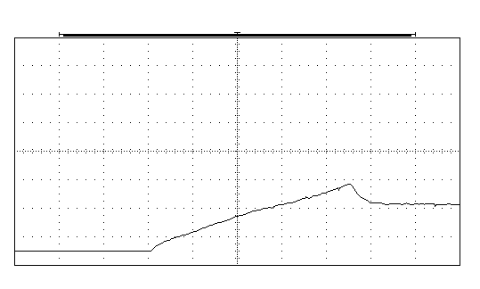

My problem is that during startup the 3.3V supply seems to do some strang things.
This is the waveform I get from the output (5mS/div horizontal, 2V/div vertical)
The supply appears to ramp upto about 3V over about 7mS,  stay at 3V for 6mS, surge upto 5.5V over 4mS and finally drop to 3.3V over a further 4mS.
The over-voltage on the output is potentially damaging the components in my system that use 3.3V.
Any ideas why this happens or any suggestions for 'tweaks' to the circuit to stop this from happening would be appreciated.
I've thought of fitting a zener diode across the output but it would need to be a large (and therfore expensive) device to cope with the energy in the over-voltage surge.
Kevin

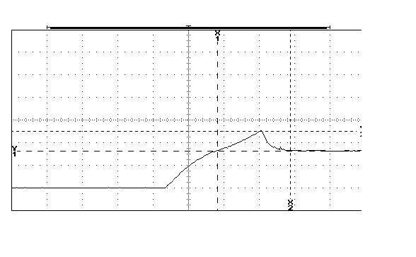

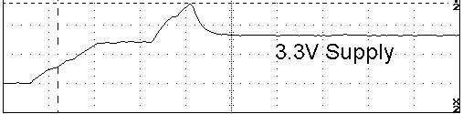

  • Hi Kening
    I have done some more tests with resistive load instead of the system load I tested it with initially.  The initial plateua has disappeared (I think this is because it normally drives a couple of boost converters) but I still get the overshoot.
    Heres waveforms for 100mA load
    and with 3A load
    The startup seems VERY slow and as you can see the overvoltage surge is still there.
    I can't get SS/FB waveforms at the moment the board is conformally coated and I can't get the scope probe through it.  However I suspect that you are correct there is something wrong with the SS/FB circuit.
