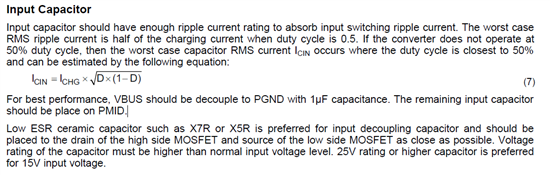

Hai All,
What is the expansion of PMID pin in. Kindly provide its characteristics.
  • Hello Balaji,
    Please explain you question in more detail to enable us to help you more effectively.
    The PMID pin serves an intermediate filter capacitor for both the buck and boost converters.
    It is also used as an for feedback compensation measurements during start-up as discussed on Pg. 21 of the datasheet.
