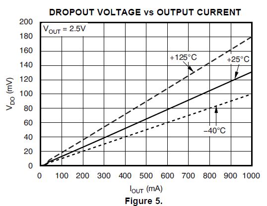

Our customer needs the graph of VDO vs. Iout at 5V output like the Fig.5 in datasheet for TPS73701. I understand that the VDO is specified with no Vout condition in electrical characteristics, so the Fig.5 can also be used for Vout = 5.0V. Is my understanding correct?
