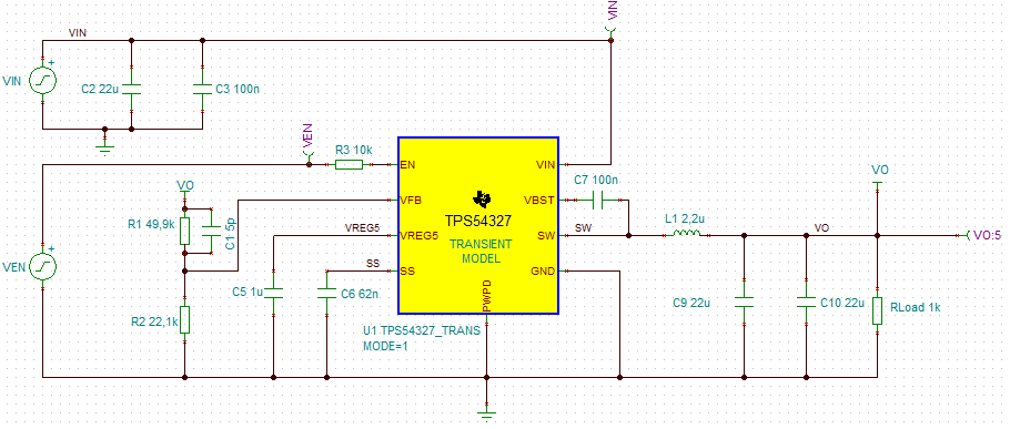

Hello.

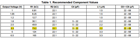

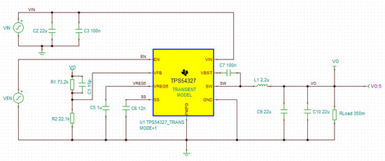

I am simulating the component with TINA, but the results are completely unexpected regarding the specs in datasheet.
VIN is 12V, and the pretended output to 3.3V.

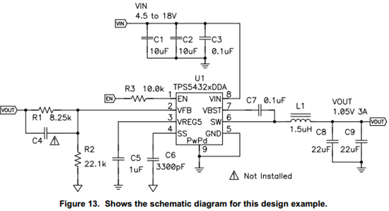

Recommended circuit in datasheet: http://www.ti.com/lit/ds/symlink/tps54327.pdf
Recommended values in same datasheet:
Circuit implementation in TINA:

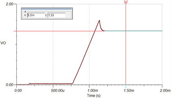

Output of transient analysis Vout = 1,33V.
What is wrong here? The output voltage is nothing to do with 3.3 V. Should I trust this simulation?

  • Try changing the load resistor.  3.3 V into 350mohm is 9.43A.
  • Hello John,

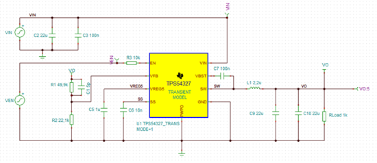

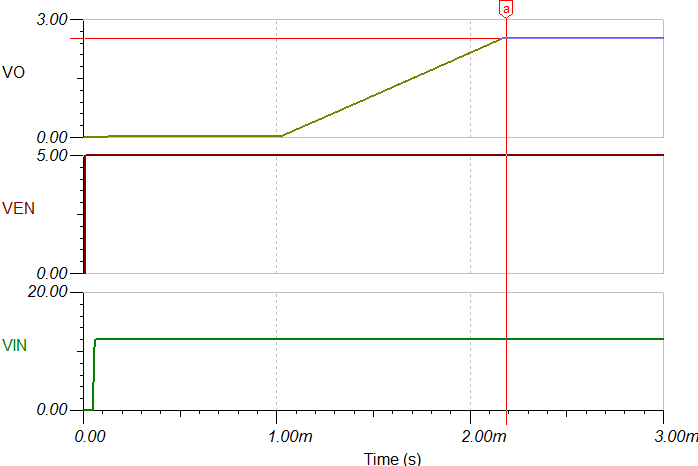

    Thank you for your help. You were right. The output voltage is the right place. Any way, I still have some issues in the same simulation that you might help me again.
    With a 18nF capacitor in SS pin, I am expecting a start up delay of aprox 7.5 ms. The Vout in simulation just takes 2.2 ms.
    Can you see anything?

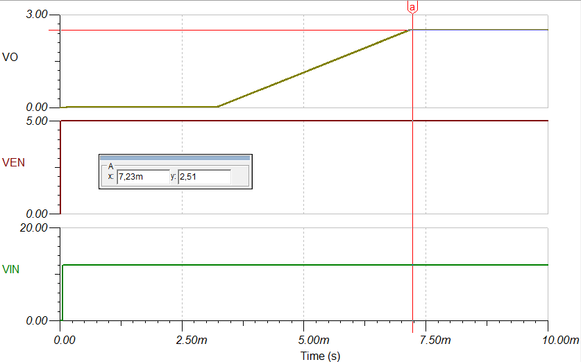

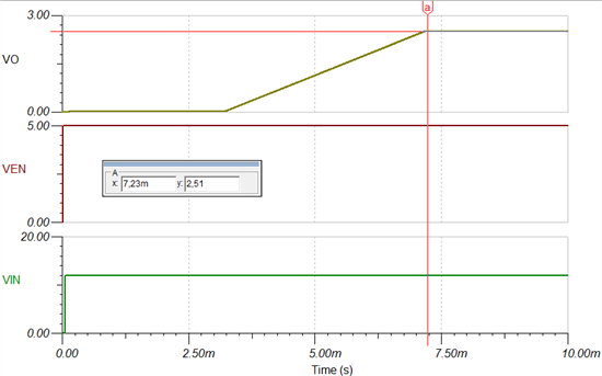

  • Hello again. Sorry to keep asking, but i need your feedback about this simulations/validations.
    To make that approx 7.5 ms delay in Vo rise, I need to use a 62nF capacitor rather 18nF.
    Is this a valid simulation of the component behaviour?

  • From the TINA model schematic notes:
    TEST BENCH DESCRIPTION:
    1. The TPS54327 Transient Model is encrypted.
    2. The testbench has been configured for VIN= 12V VOUT= 1.05V, Iout = 3A
    3. This application has been corner tested for input voltage ranges: 4.5V to 18V and Iout: 0A to 3A.
    4. MODE is a parameter used for FAST SoftStart. Set MODE = 1 for fast startup time ( 6x speed of normal softstart) to enter steady state faster.
        Default is MODE=0 used for normal softstart based on Css.
    5. Operating current and shutdown current have not been modeled.
    6. Thermal characteristics of the part have not been modeled.
    You are operating in MODE = 1 so your slow start times are artificially fast.
