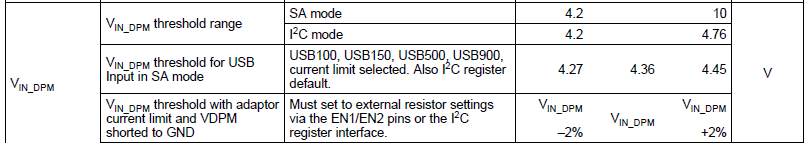

    Also the fact that VDPM is programmed to 5V with a 5V input is also creating a potential issue. There is an inherent voltage drop that will occur across the device. The range for the VDPM for a 5V USB input is given below. Try adjusting your resistor divider of R2 & R4 to hit 4.45V to see if this feedback loop is creating your issue.
