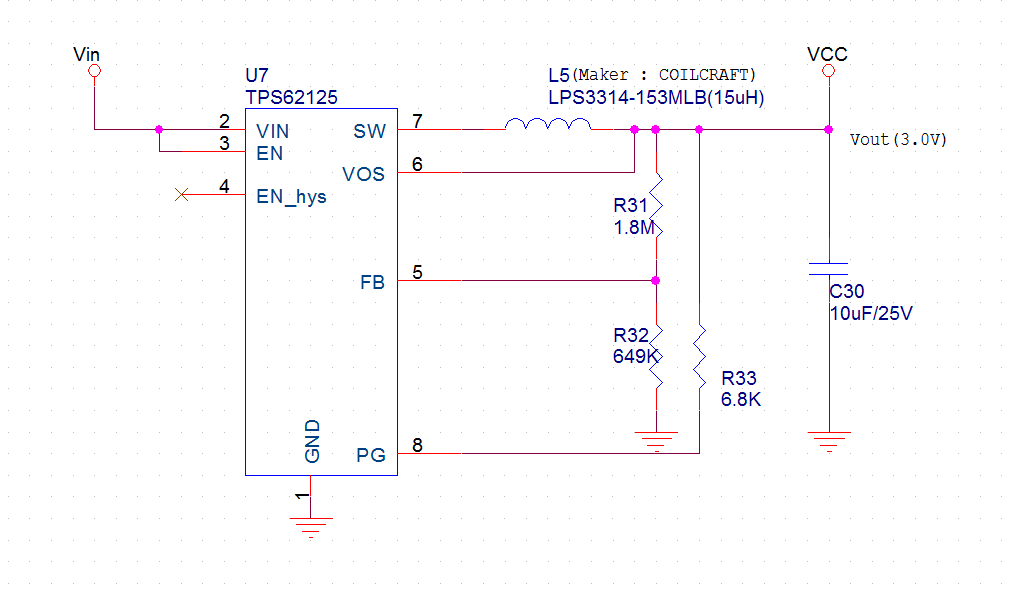

Hi~
I want to make a "3.0Vdc with TPS62125DSGT.
So, I was connected as shown below TPS62125DSGT.
But does not come out any output.
Did I do something wrong?
Hi~
For sure, you need an input capacitor.
If it still doesn't work for you, make sure everything is soldered down well and then post a scope capture of Vin, Vout, and SW.
