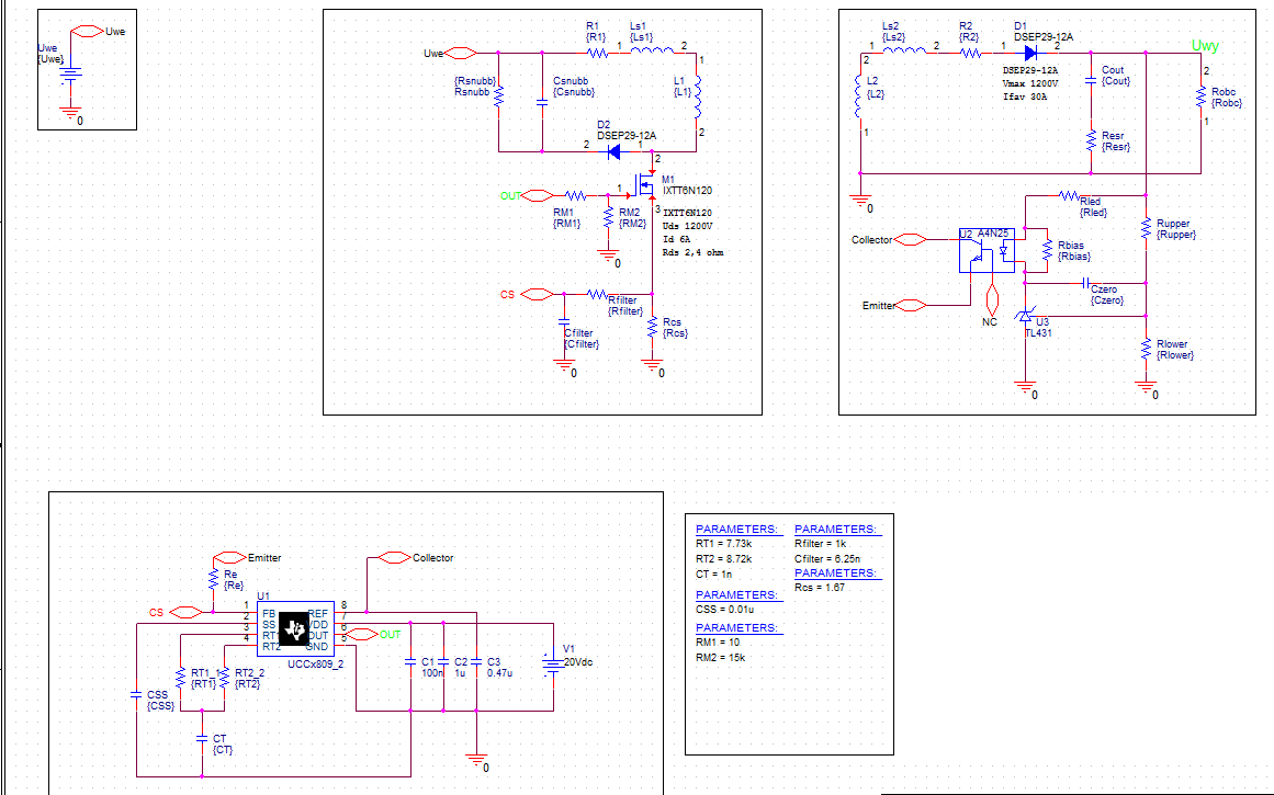

FLYBACK UCC3809 OrCAD/PSpice convergence problem
hello
i'm tring to simulate flyback with UCCx809-2 controler and i have
some problems with simulation. i have convergence problems. i'm using OrCad 16.3:

Almost all errors refers to UCCx809-2 controler (X_U1).
When i set autoconvergence i have less errors:

Now errors refers only to controler.
When i simulate independently the power section and feedback loop with the same
values i don't have any problems
What should i do to run this simulation?
    The convergence problem can be caused by a lot of reasons.
    I can only suggest you to try modifiy the simulation setting such as maximum steps.
    Or modify the initial value of components.
    Or maybe you can ask the question in simulation and models forum
