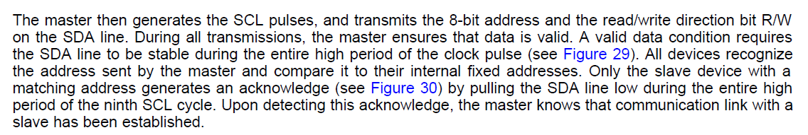

    yeah i download the GUI nd i m using it .
    for example i m going to write a function that chek if the mode  USB or the IN is working so i want to chek the bits B4,B5,B6; of the register 'Status/Control Register'
    how can i chek that ?
    If you look on Pg. 26 of the datasheet it discusses how to request the contents of any of the control registers. Once you have this this register information you could AND the pulled register contents to isolate the bits you are interested in.
