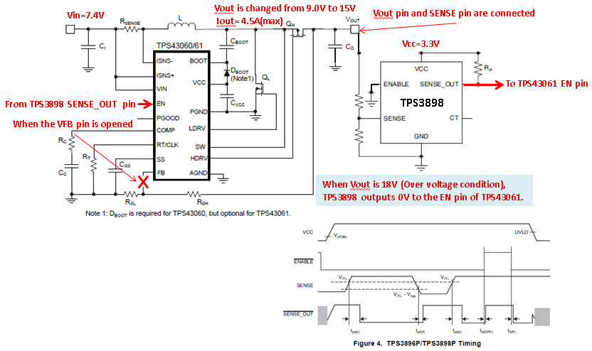

When the VFB pin is opened, the output voltage of TPS43061 continue to rise over time.
Therefore, my customer would like to set an external OVP circuit.
Please let me know if you have a recommend external OVP circuit.
<Condition>
Vin= 7.4V
Vout is changed from 9.0V to 15V.
