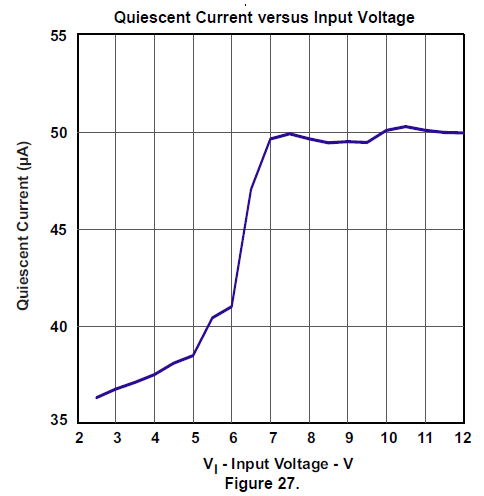

My customer would like to calculate a dissipation power(Pd) at Iout=0mA(no load).
Therefore, we would like to ask about quiescent current (Iq_out).
[Q1]
Could you please send us it, if you have a graph such as Figure27?
So, I would like to ask whether the Iq_out is changed by the output condition.
[Q2]
My customer will calculate as follows.
Therefore, we would like to ask about Iq_out.
Please let me know if we are mistaken.
<Pd at Iout=0mA(no load) calculating formula>
Pd = (Vin*Iq_IN) + (Vout* Iq_OUT)+ (VEN * EN,PS/SYNC input current)
I’d greatly appreciate your verification.

  • Hi Kanemaru-san,
    let me briefly summarize the answers:
    Q1:
    We specify the Iq at VOUT just for VOUT = 5V
    Q2:
    With this approach, you can basically calculate the dissipation for idle condition
    Q3:
    For PS/SYNC = high, the device is forced in PWM and has more inrush current for idle condtion
