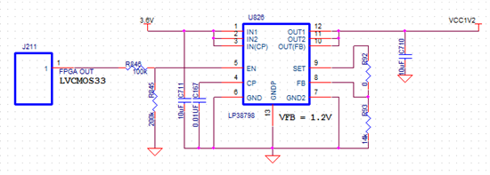

We are trying to use LP38798 in a noise critical design. It uses a 3.6V input and a 1.2V output.
1) R1 is selected as ~49.9 ohm and R2 = 14k. Assume this shall have no issues with 1.2V out.
2) enable logic needs to be low at start up and only enabled by a FPGA 3.3V LVCMOS output later. Datasheet suggests to use an open drain logic instead. Can you please suggest the exact logic? Can we avoid using an external bjt/fet?
