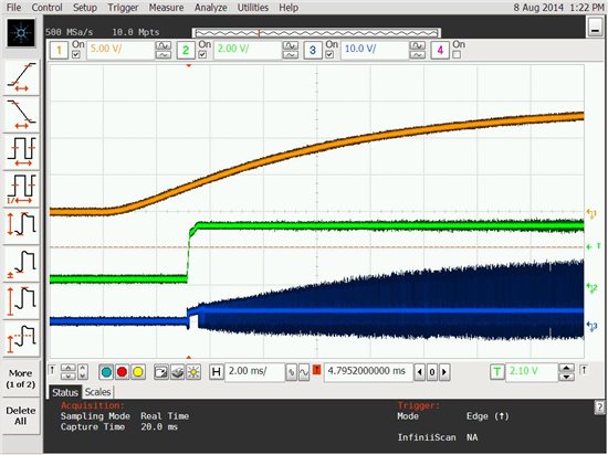

  • Sorry about the delay - it was difficult to get a temperature chamber.
    The first set of plots was taken at 80 deg C at initial power on (i.e. not a crowbar test).  Trace 3 is SW.

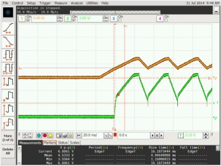

    This set of traces shows another mode that we sometimes see after a crowbar test at 80 deg C.  The power supply was current limited to 200mA.
    Again, this failure to regulate does not occur on every board and appears to occur only over a limited temperature range (roughly 80-85 deg C).  The power supply supply appears to ramp up faster for initial power on versus the crowbar test.  Would this be causing problems?  Any help in troubleshooting would be most appreciated!

  • Thanks for the date code and waveforms.  It is a TPS62172 device.
    Was the second waveform showing it recovering from the crowbar test?  If not, could I see this--Vin going to some near 0 level and then coming back up?
  • Yes, the second set of waveforms is for the regulator recovering from the crowbar test.  In this instance the output of the regulator did not go into oscillation but does settle at roughly 7V instead of the desired 3.3V.  Note the difference in time scales between the two sets of plots.
