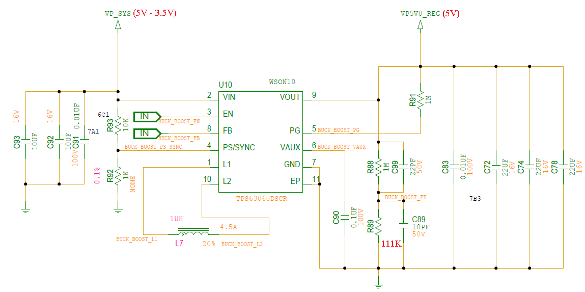

TPS63060 output drop from no load to 40% load
Other Parts Discussed in Thread: TPS63060
I am using TPS63060 part in my proto design(attached the circuit). During testing from no load to 0.4A load transition(Vin= 5V), I found stable 0.4V output voltage drop at power save mode and stable 0.25V drop at power save disable mode. Please help me to fix this issue.
My input - Adapter(5V) or battery voltage(3.5V to 4.35V)
Output Voltage = 5V
