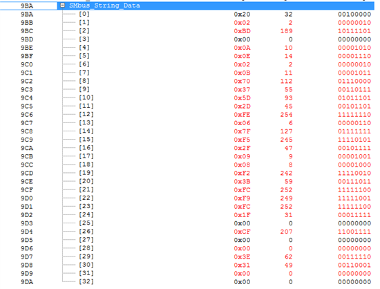

During product Manufacturing we will not have access to  EVM software or PRO screen. We are creating a stand alone production test unit based on a hacked version of our battery charger since it incorporates a micro and SMbus capabilities to interface with the battery packs.  The main reason is to limit operator interaction with the flash file and gas gauge settings. We need to reset the lifetime max temperature prior to shipping the battery pack and were hoping to use the system flash page access to modify the lifetime temperature value.  Understanding how the PRO screen worked may have helped us figure out how to retrieve the data we needed.

When I use my code to read back the page using 0x73,  I receive the correct data and can read and write other sections of the chip using these same functions.

 Read_SMBus_String( battery_address, page_number, bytes_to_read);
Attached is a screen shot of the data received back from the above code and the correct data from 0x73

screen shot good data:
Screen Shot Bad Data

    I believe there is a mistake in your code above is where you have sub_class = 0x0059.
    59 is the decimal subclass value for lifetime data so you want to convert that to 3B hex ,
    I managed to get wrting to max temp via the Pro screen to works as shown here
    I had previously used the FLASH screen to change the life timemax temp to 40 C ( default is 30C ) .
    40 is represented as  0190 hex as each bit is 0.1C.
    So I wrote 003B ( ie 59) using write SMB Word 77 as my first step per c.1.4 on sluu386 page 102 section .( you can see it above) . I am ignoring the slave address entry step.
    Then I did a read SMB Block with SMB command 78 and you can see the result at offset 0 was 0190 as expected.
    So to see if I could write something else as the Max temp  I copied that complete block ( all 32 bytes - the little window does not show them all) into the the Write SMB block window, and then manually edited the 0190 to be 012C ( where 0120 should give me 30C , ie it is 300 in 0.1C bits). I set the SMB Command to write as 78 and clicked enter.
    Then when I switched to the FLASH screen and did a 'read all' l I saw that  my life time max temp had changed from 40  to 30.
