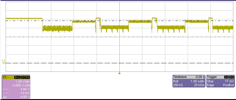

I have a customer who has an unstable 5V input that drops to ~4.1V that lasts for about a second, then shoots back to 5V.  He's looking at the TPS61230 to create a stable 5V rail and is asking for a simulation to see if the 61230 will stabalize at 5V.  Attached is a screenshot of the unstable input.  Can someone run a sim with an input close to this and post screenshots of the output, or advise on the best way to simulate it.

    As of right now, the customer does not have a TPS61230 design.  He is trying to figure out if the 61230 will be able to stabalize the 5 to 4.1 voltage drop to his required constant 5V.  In other words, assuming an ideal load, will the TPS61230 work for stabalizing this input?  I tried simulating its PSpice model on cadence, but ran into issues getting the program to run properly.  I also tried exporting a schematic from webench to a cad tool, but that did not work either.

    got it. i think u can just do the simulation (input transient) with our webench calculator on TI official website. here are some captures from an design with VINmin=4.1V  VINmax=5V IOUT=500mA:
    select input transient in step1 option. then click VIN in the schematic to set rise/fall edge time. this VIN is periodic, may not generate the signal you posted yesterday.
    here is the result I did:
    VOUT can be stabalized at 5V.
