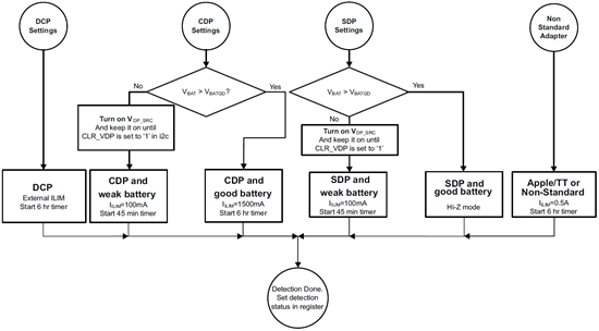

    In standalone mode, the input current limit is only determined by the D+/D- USB detection. Your external ILIM settings look correct, however it seems the IC doesn't detect DCP.. According to the below chart, looks like it detects non-standard adapter. Can you try shorting D+/D- together and see if you can get what you programmed ILIM and ICHG? This should put the device in DCP.  Just to make sure that the IC can detect the correct condition.

    To be able to detect DCP, the D+ voltage need to be below 0.9V threshold for primary detection. Once the voltage is above 1V, the IC will detect non-standard and will limit the current to 500mA.

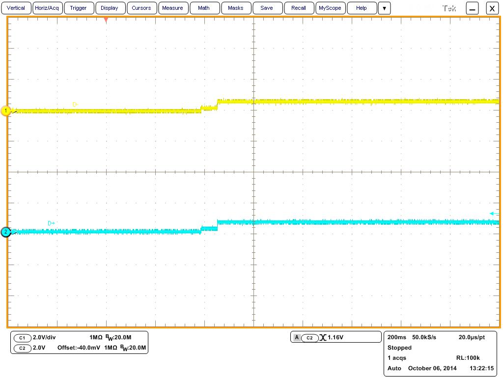

    I used a dedicate charger port and plugged it into the bq24257EVM, the signal on D+ and D- is as below. D+/D- is shorted together and the voltage is about 660mV. The current limit is determined by the external resistor.
    Do you have any idea why the D+/D- pin voltage is that high? Have you tried with different USB cable?
