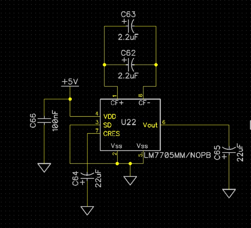

Hello everyone,
I am new to using one of these parts but I have created a circuit that were I will take 5 V and bring it down to -0.232 V.
Would someone be willing to check my work to ensure that it will work this way? (For the top caps, I tried finding a 5 uF capacitor but digikey did not have them so I had to choose two 2.2 uF)
