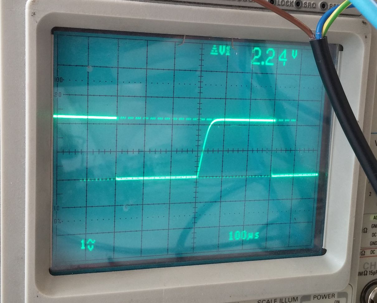

It seems that the temperature is measured incorrect. The voltage at the OTP is 2.5V which is way too high (if it exceeds 1.15V, an overtemperature fault is detected and the switching regulator switches of everything). So I measured the voltage at the D+ pin to see what is measured by means of the NPN transistor. Here is a picture:
Here I can see a deltaVbe of 2.24V which is also way too high. The PCB is at room temperature.

  • Ok, after some more investigation I found out, that the Webench design is not that correct as it should be. The datasheets states that the D- input (used for the temperature measurement) hast du bie tied to GND. This important fact was not shown by the Wenebch design.
    After I connected D- to GND the voltages at D+ and OTP are reasonable. D+ shows the behaviour as axpected from the datasheet (deltaVbe of 60 mV) and the OTP pin has a voltage of 0.89 V.

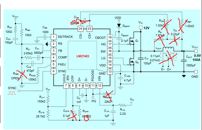

  • I was having the same problem This is what I assembled
    It only got up to 100mv under no load but it was stable. When I added a  0.1ohm load it didn't regulate at all.
    here is the Design tool exel file12-01-2015assembly.xlsx
