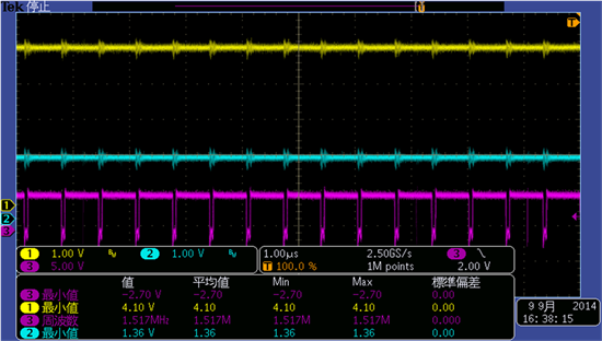

Attached figure is normal switching wavefrom for BQ24250.
Yellow:VSYS, Magenta:SW.
There is no VBAT, however VBAT is 4.0V (Expecting CV charge). And load current of VSYS is 0.5A.
In this case Fsw is almost 1.5MHz, not 3.0MHz.
I understand this device is fixed frequency of 3MHz. Is there any reason why it become 1.5MHz?

  • Hello, Wenja
    Attached is waveform, we can see 1.5MHz switching and Duty cycle seems enough to maintain PWM.
    As for battery detection routine, we also observed, but hitting Vsysmin is very first response within 15ms
    just after battery removal. I would like to confirm this 1.5MHz first and then proceed to response because
    1.5MHz (with 1uF) is not our expectation.
    Yellow:VSYS, Magenta:SW. Please ignore blue line.

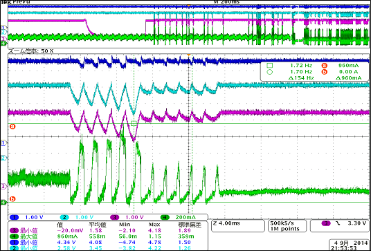

  • Hello, Wenja
    Thank you for your quick reply.
    VIN in 5V by AC adapter. The system load is 500mA. The VBAT is true battery and seems CV.
    Before battery removal switching frequency is 1.5MHz not 3MHz. And then removing battery.
    The waveform just after battery removal is below.
    Blue:Vin, Cyan:VSYS, Magenta:VBAT and Green is IVIN.
    From this waveform it can see bad response when removing battery. These is many unknown phenomena,
    (i.e. If  VSYS drops just after removing battery, it seems in supplement mode before battery removal, but
    this waveform shows VSYS>VBAT, I think it was in charge phase.)
    I understand 3MHz with 1uH and 1,5MHz with 1uH have different response, so I would like to confirm why
    fsw is 1.5MHz  before battery removal first. And then start investigate its response.
  • Hello Wenja
    This is additional info. We can see
    1. VIN=5V, SYS load=600mA, Charge disabled -> 1.5MHz switching frequency
    2. VIN=5V, SYS load=0mA, Charge enabled (Actual ICHG is 100mA) -> 3MHz switching frequency
  • Hi Keiichi,
    I was able to recreate the 1.5MHz frequency. What happened is when the duty cycle is above 94%, the minimum requirement of the 'OFF' time is not met, so one falling and rising edge is skipped. Under this condition, the system output should be stable too. Can you please verify that when this happens, the difference between VIN and VBAT (measured from the pin) is less than 800mV? If you increase VIN or decrease VBAT, the duty cycle will decrease and the frequency should be back to 3MHz.

  • Hello Wenja,
    Thanks for your help. I understand the scenario why fsw become 1.5MHz.
    For potential VBAT after battery removal, I agree with you. I will confirm it to customer.

  • Hello Wenja,
    I did several labo experimental and confirmed duplicating condition.
    The /CE should be high in order to see bad VSYS response during battery removal (and connect also).
    Sometimes in battery removal when /CE=H let VSYS below VSYSMIN at TI EVM.
    I think that the "supplement mode"  do something, but I cannot understand scenario.
    Could you let us know why it occurs?
