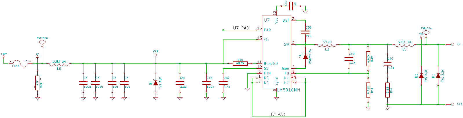

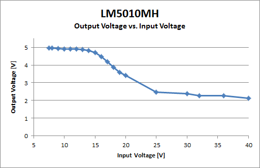

Hi, I'm trying to use the LM5010MH to convert input voltages in the 10V to 48V range down to 5V.
The design works fine for low voltages but the output drops to an unusable level above 15V.  Here is a graph with more data points:
Here is the schematic for my circuit:
The inductor symbols labeled "33ohm 3A" are SMT ferrite beads.
I've also attached the Webench design that the implementation above was based on.  I tried to use the exact parts listed in the Webench bill of material.
I would like to increase the range of input voltages to the LM5010 that will give me 5V on the LM5010 output.  Any thoughts or ideas for troubleshooting?
Thanks!
- Chris

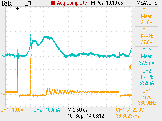

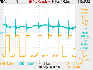

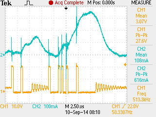

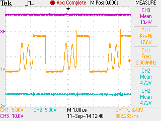

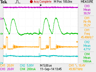

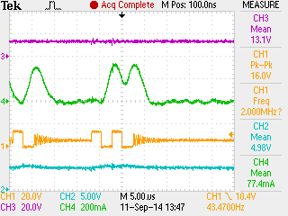

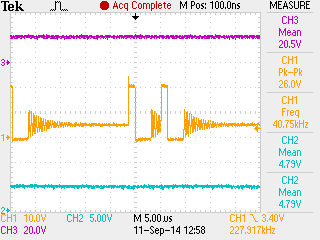

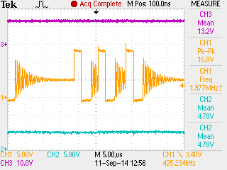

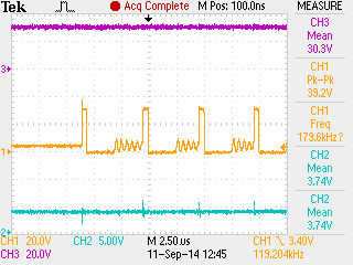

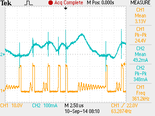

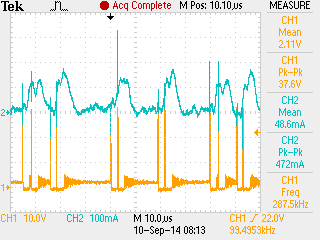

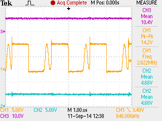

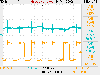

  • Hi Vijay, thanks for the reply!
    In the scope traces below CH1 is the SW node voltage and CH2 is the inductor current.
    This is for an LM5010 input voltage of 10V, which gave an output voltage of 4.84V (the part is working correctly):
    This is Vin = 13, Vout = 4.63V (the part is working correctly):
    These next two are both Vin = 20V, Vout = 3.026V (the part is not working):
    These next two are both Vin = 30V, Vout = 2.120V (the part is not working):
    Obviously some differences in the outputs.  What do you think this suggests?
    Thanks!
     - Chris
  • What is the load current? Also inductor current does not look like usually inductor current waveform. How are you measuring it?
  • I'll have to measure the load current tomorrow.  For what it's worth, as I recall (I could be wrong), the input current starts off around 50mA and drops down with the voltage.
    To get the current waveform I used a Fluke 80i-110s AC/DC current clamp connected to my Tektronix o'scope.  To take the measurement I de-soldered the inductor and used two wires as risers to lift the inductor off of the PCB pads.  Then, I put the clamp around one of the wires.  Is there something else you would recommend?  A current sense resistor or something else?
  • The way you are measuring the current seems ok. But your inductor current waveforms don't look right. They should be triangles. Also the webench design suggests ~500kHz switching frequency. The waveforms are ~750kHz.
  • The inductor ripple current is predicted in the webench design to be 100's of mA. But the pictures show much smaller values.
    Is there a gain term on your current scope.
    I good way to start debugging the circuit will be to reduce the frequency using the RON resistor (say to 100k(ohm) or 200k(ohm)).
  • I actually just saw that the current clamp specs say the usable frequency is DC to 100 kHz...

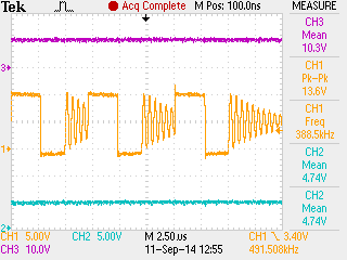

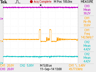

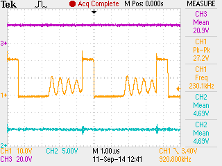

  • Here are the results from changing Ron from 48.7kΩ
    CH3 is the input voltage, CH1 is SW node voltage, CH2 is the output voltage
    Ron = 100kΩ, Vin = 10.4V, input current = 0.04A, load current = 81mA:
    Ron = 100kΩ, Vin = 13.4V, input current = 0.03A, load current = 81mA:
    Ron = 100kΩ, Vin = 20.9V, input current = 0.02A, load current = 81mA:
    Ron = 100kΩ, Vin = 30.3V, input current = 0.04A, load current = 63mA:
    Ron = 200kΩ, Vin = 10.3V, input current = 0.04A, load current = 83mA:
    Ron = 200kΩ, Vin = 13.2V, input current = 0.04A, load current = 83mA:
    Ron = 200kΩ, Vin = 20.5V, input current = 0.02A, load current = 82mA:
    Ron = 200kΩ, Vin = 30.2V, input current = 0.04A to 0.1A, load current = 72mA to 76mA:
    Changing Ron to 200kΩ made the maximum usable input voltage go up to about 23.5V, which is an improvement but still a long way from the webench design of 50V.  I'll try increasing Ron more: do you think increasing Ron/decreasing the frequency could cause any negative issues?

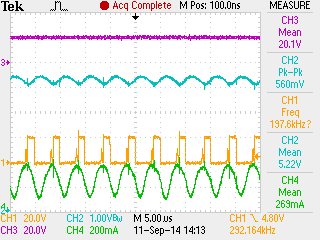

  • After changing Ron to 200kΩ I can now see the triangles in the inductor current waveform (CH4) you were expecting:
  • Vin [V] Iin[A] Vout[V] Iout[A] Vout(pk-pk)[mV]
    10 0.13 4.75 0.24 380
    13 0.10 5.09 0.24 440
    20 0.07 5.22 0.242 520 to 600
    30 0.04 3.36 to 4.7 0.200 to 0.204 720 to 960
    Here's the o'scope for 20V, these all have Ron at 200kΩ:
    10 0.16 5.04 0.280 360
    13 0.12 5.06 0.280 440
    20 0.07 4.72 0.260 640
    30 0.04 3.57 to 4.01 0.204 760 to 1040
    When doing our design, we didn't know the exact current output we would need.  The above is close to worst case: we probably will never have to supply 330mA.
  • Is it possible to increase the output capcitor. If you can please try increasing it to 15uF or 22uF for this test.
    Also the increase in the output voltage with VIN makes sense (first table)
    decrease in output voltage with VIN does not make sense (2nd table).
    I may at some point need to look at the layout of your board.

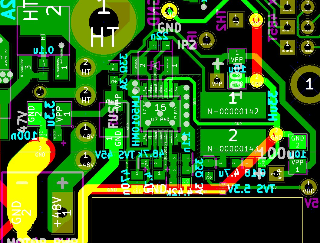

    Here's the layout of the dc-dc portion of the layout:
    The LM5010 is in the middle on the bottom layer.  The top layer over the LM5010 is copper filled to dissipate the heat, but it's not shown here as it would just make everything harder to see.  You can see the vias though that connect to the top copper filled pad.
