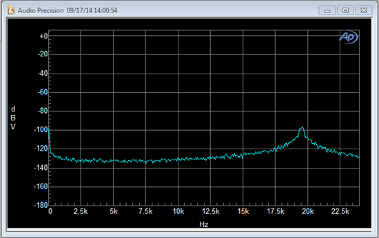

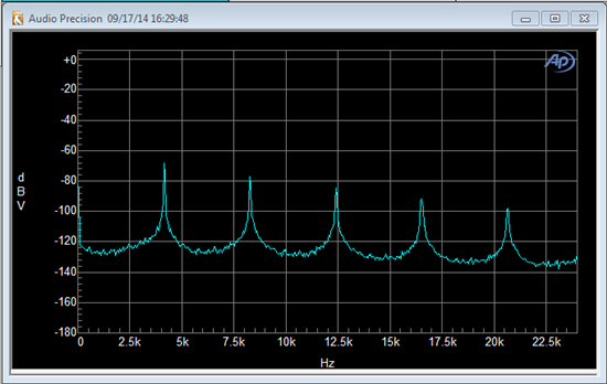

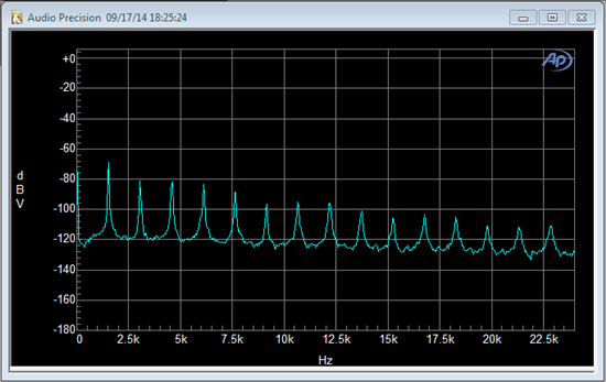

I am having an issue with noise generated by the LP5907SNX-3.3/NOPB LDO on a current project.  This part was selected for its ultra-low-noise characteristic.  However, I am seeing strong periodic noise generated at the output.  Below is a simplified schematic:

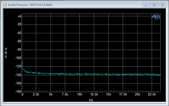

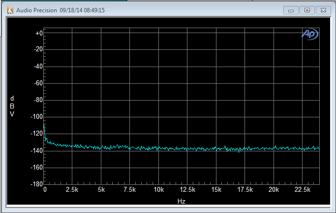

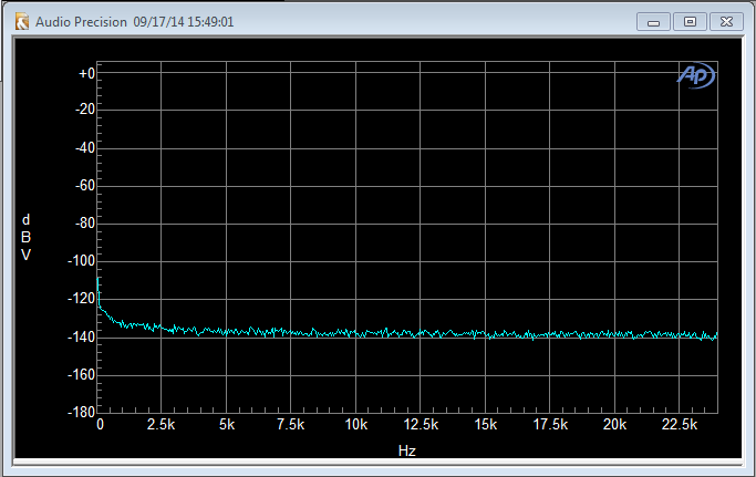

 In my circuit, VIN is 4.0 V and VOUT is 3.3 V.  The frequency and level of the periodic noise appears to vary from component to component.  In some devices it is a broadband hump and within 10~20 dB of the noise floor.  In the worst devices, it is a fairly narrow peak with strong harmonics.  The periodic noise is load-dependent and roughly inversely proportional with the R and C values.  Thus, I can move the noise out of my band of interest (24 kHz audio) by placing a small parallel resistive load in my circuit.  When I use a ~1 kΩ load, the periodic noise moves completely out of band and I see a relatively flat ~140 dBV noise floor.  I chose a relatively aggressive 1 kΩ for my project, because there is part-to-part variation in the noise and I want to be confident that the solution will work across all devices.  However, that is an extra ~3 mA that is unnecessarily dissipated.

I did read in the LP5907 datasheet that a very low ESR output capacitor is required for stability, so I tried a variety of lower-ESR capacitors and parallel capacitor combinations, but this seemed to have no effect on the noise.  The datasheet says that the input voltage should be at least 1.0 V higher than the output voltage, so I swept VIN from 4.0 V to 5.0 V, but observed no effect on the noise.  There is also a note suggesting that the input capacitance should be at least as large as the output capacitance, so I increased the input capacitance to 10 μF and observed no effect on the noise.
Does someone have any thoughts on why this is occurring and if there are any alternative methods of mitigating the noise?  The total noise I am measuring is about 570 μV, significantly higher than the 10 μV in the datasheet.

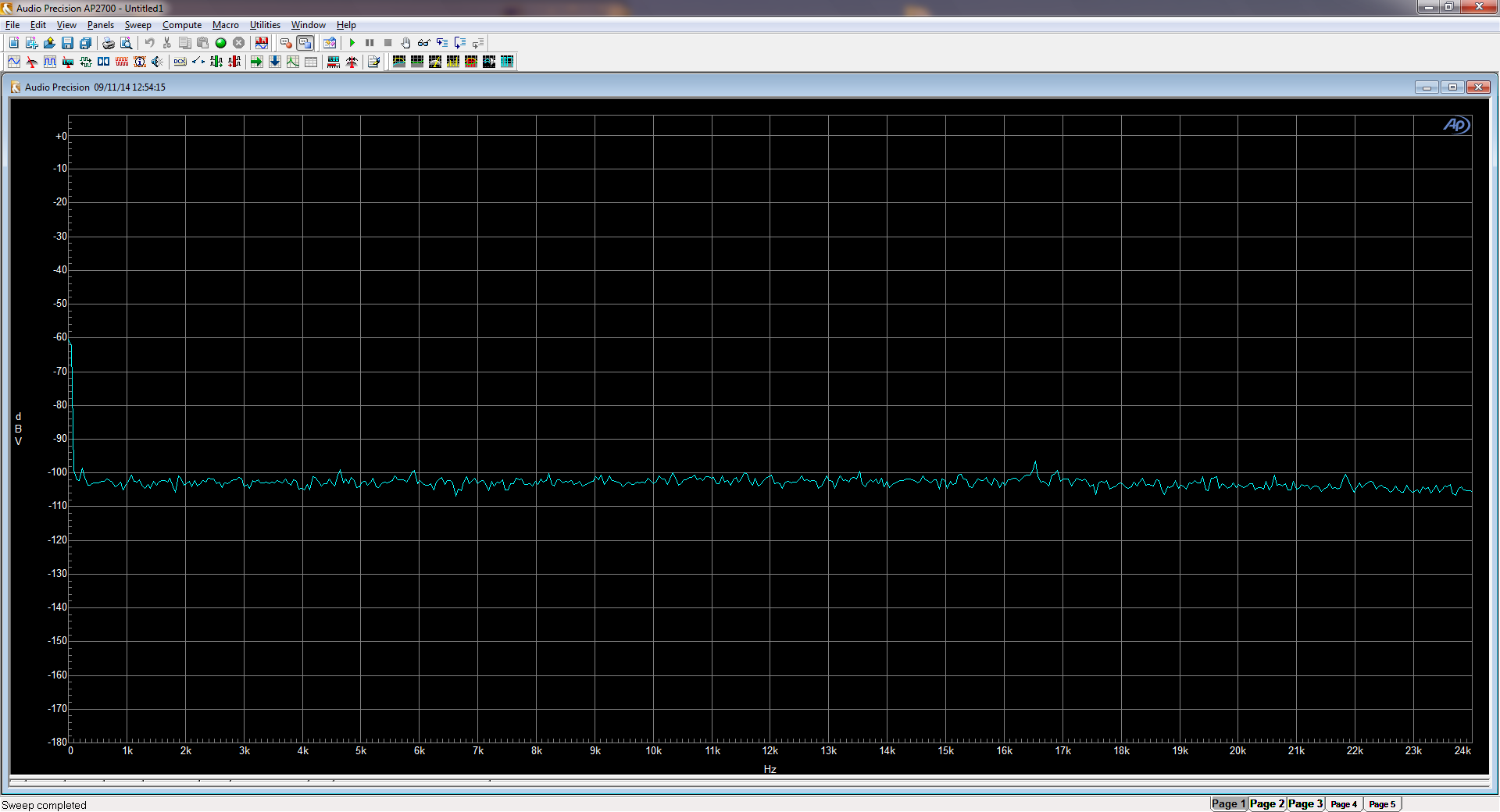

VIN noise:
VOUT noise:
  • "... strong periodic noise generated ..."
    This does not sound like noise.
    This is probably not from inside the LP5907. It is more likely the LP5907 response to something external. Knowing more about the load and conditions might be helpful.
    The fact that adding 1k load resistor changes the ~noise~ suggests a couple of items:
    1) LP5907 is not happy with only 66uA of load current
    2) The load pole (1 / (2 x pi x Cout x (Vout/Iout)) moves to a higher frequency, improving response. In this case the load pole is so low that this seems an implausable explanation
    3) There is some type of resonance on the ouput and adding the resistor damps out oscillation.
    The LP5907 does not have a Vout spec for less than 1mA load, but we have characterized Vout for a small sample down to 100uA load.

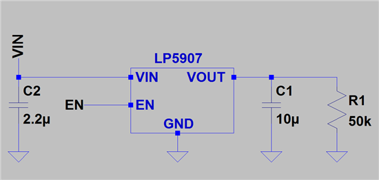

    If you put the LP5907 into the simplified circuit (i.e. just a 50k ohm resistive load) does this behavior persist?

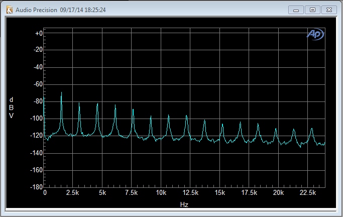

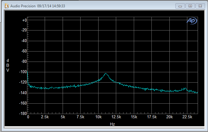

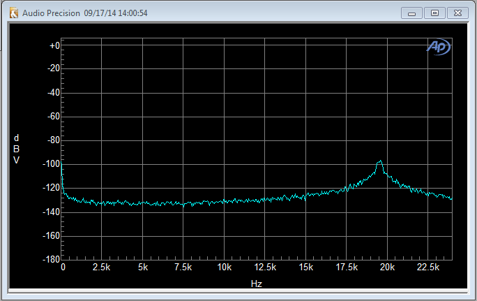

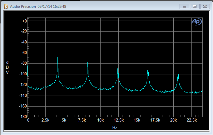

  • The above measurement was taken with a 50 kohm potentiometer as the load.  The measured load is actually about 53 kohm.
    As I decrease the resistance on the pot, the frequency correspondingly increases.  At 38 kohm, the fundamental is at 10 kHz.
    Interestingly, as I continue to decrease the resistance, there is a point where the frequency seems to "skip" ahead non-linearly.
  • If load R is kept the same (50k) but Cout is changed from 10uF to 1uF (i.e 1/10th), does the frequency go up by 10x?
  • Decreasing Cout by about half (10uF to 4.7uF) does approximately double the frequency.  I have not checked 1uF, but I will confirm.
  • Then this is probably related to operating at much less than the rated 1mA load current with 10uF Cout.
    Control loop overshoots a little bit then has to wait for the 10uF Cout to discharge through the 50k, then repeats the cycle.

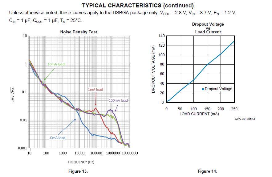

  • Is the recommended solution then to just use a 1uF Cout and >1mA dummy load?  Figure 13 in the datasheet leads me to believe that the noise has been characterized at 0mA load.
  •  " ... Figure 13 in the datasheet leads me to believe that the noise has been characterized at 0mA load..."
    Possibly, with Cout = 1uF.
    I checked the archives and I didn't see any comments from the original characterization team regarding this chart. (Fig 13), or any design notes regarding issues for output loads near to zero mA.
    At this point the recommended solution would be to use a 1uF Cout.

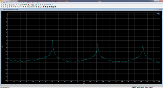

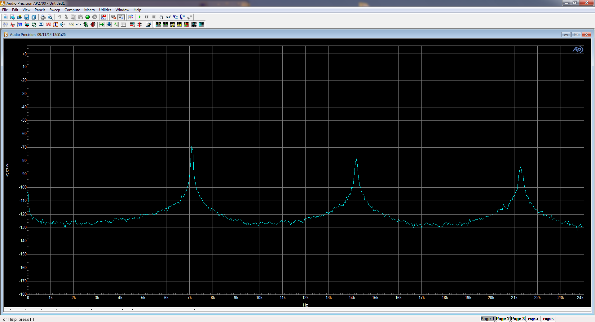

  • I've made some more measurements.  As you can see, the noise is still apparent at light loads, even with Cout = 1uF.  I will move forward with 1uF, 1mA load as my solution.
    Meanwhile, would it be possible to review or amend the datasheet so that a minimum load requirement is made clear?
    10uF 150kohm
    10uF 60kohm
    10uF 3.3kohm
    1uF 150kohm
    1uF 60kohm
    1uF 3.3kohm
  •  " ... amend the datasheet so that a minimum load requirement is made clear ..."
    Yes, I had that discussion with management yesterday. Not sure if we can ~erase~ the 0mA line from the Noise Density chart (aka Figure 13), or if a new chart needs to be created from scratch.

    My project has four microphone input channels, with one LP5907 per channel sourcing mic/amp bias.  I took similar measurements of all four channels on one board.  The worst-case on this board is channel 2.  If I depopulate the LDOs and replace them on different channels, the noise profile follows the LDO.
    5531.LDO noise.zip
    I've also observed similar behavior on different boards, with each LDO exhibiting different noise profiles.
