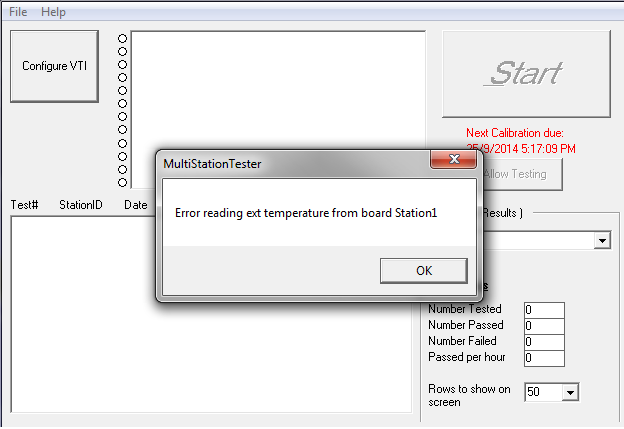

I am currently using Bq20z90 v1.50 and am preparing it for mass production. Currently using the BQ multi station tester HPA495, and having issues with it not able to detect the temperature probe.
I have also tried the using the internal temperature probe but still the error comes out.
Any ideas on what went wrong?
  • It seems that I have solved this issue with an externally power USB hub.
    Later on when starting the calibration, I got this error code of 65538.
    This Advanced BQMtester is compatible with the BQ20Z90 but the error mentions that I have a hardware incompatible.
    Any help would be appreciated.
