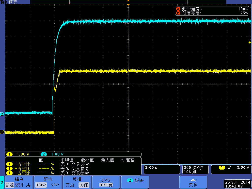

No PH waveform of TPS54610 @Vin=5.6V Vout=3.8V fsw=500kHz in no load
Other Parts Discussed in Thread: TPS54610
      I have used tps54610 for years. In a new design, I used three units to convert 5.6Vin to 1.2V/2.35V/3.8V 4A. Below the is SCH.

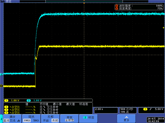

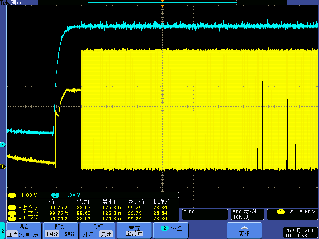

       I find when I set the fsw=500kHz, after power-on in no load, the PH equals configured Vout for several ms, then start to switch. It seems tps54610 act like a LDO at first time before begin switching. If I add some load, the phenomenon disappers.

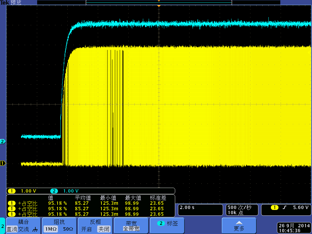

       I changed fsw to 350kHz, it didn't happen in no load. I would like to know how this come?
