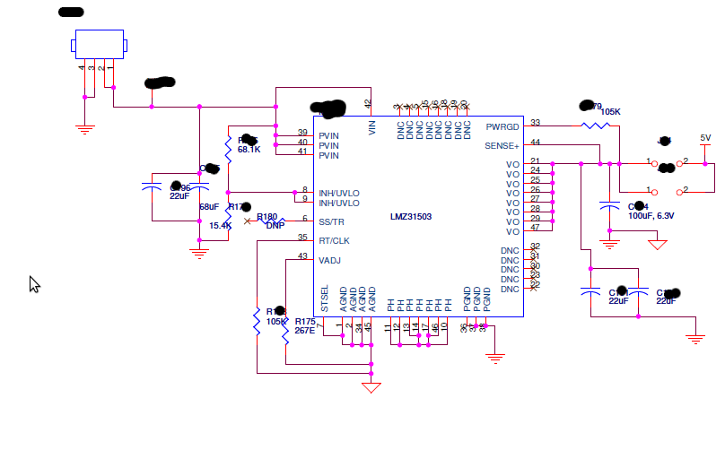

I am using an LMZ31503 in a design and on no load (with load disconnected), it seems to draw about 30mA.
Is there any explanation on the same. My schematic reference is shown below:
Please advice.

When the device is powered on and regulating an output voltage, I would expect around 20-30mA even with no load attached. Powering the internal circuitry and switching the FETs does draw consume power even if it is not delivering to the load.
