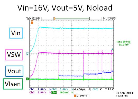

    Also , I have additional question about start up.
    Please see the attached image.
    In attached image, VSW pulse was skipped at start up.
    As a result , Vout is increased as step by step.
    Is switching pulse skipped at start up due to softstart function?
    Ryuji Asaka
  • Hi Asaka san
    Yes this is expected behaviour, the soft start feature allows the output to gradually reach staedy-state operation, thus reducing inrush current.The internal soft start brings the output up in about 15ms.
