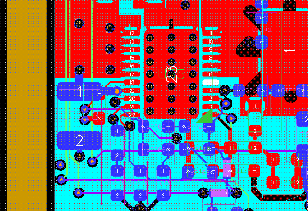

We have just entered mass production of a projector where the TPS53353DQP is used as a converter for FPGA core voltage. We have already manufactured approx.100pcs without problems but now we have 3 boards of 15 where the TPS53353DQP is damaged. For the moment we have full attention on the manufacturing process but we also need to understand critical mechanisms that could cause TPS53353DQP damage. The nature of the IC damage is short circuit between Vin, LL and GND which seam to be a breakdown of both MOSFET's in the output stage.

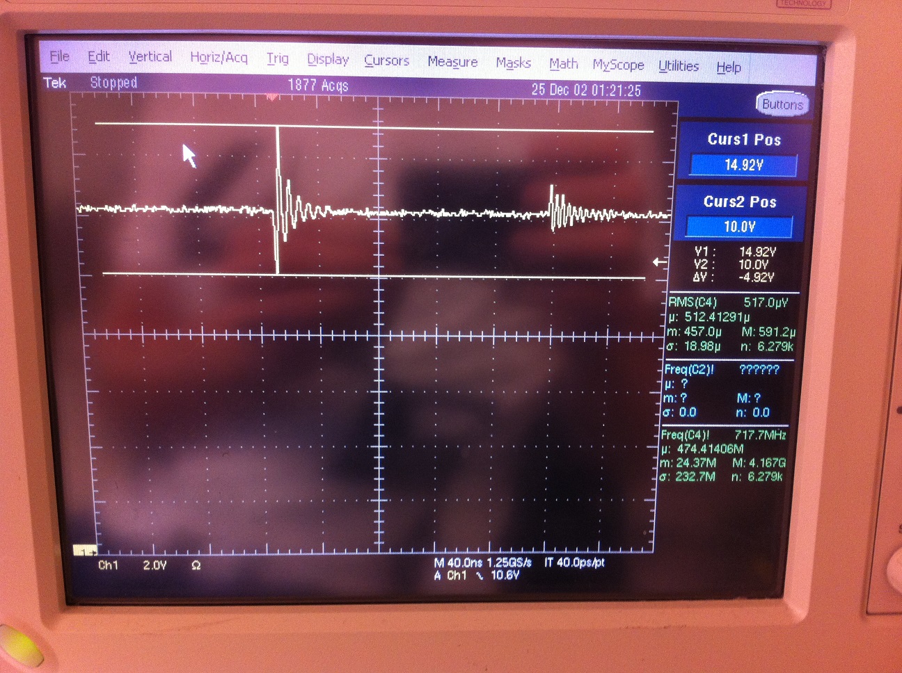

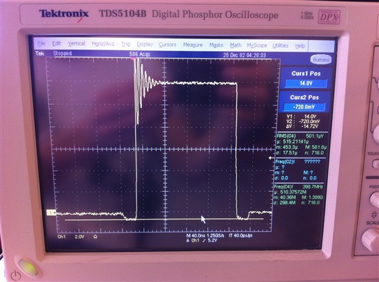

We have measured Vin on the board during relevant processes during manufacturing but can not see any transient voltages above 15V. Max temperature of the TPS53353DQP during the manufacturing process(after soldering) is 65C
Is there any other critical conditions or settings of the TPS53353DQP that could cause breakdown of the internal output MOSFETS (e.g. cross conduction).?
