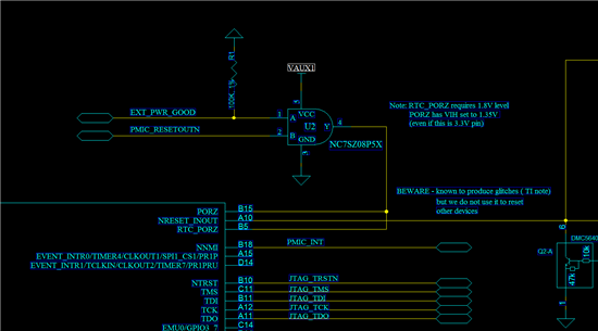

I have system with two independent modules - each has AM335x with own TPS65910A31.
They are connected with each other, so I wanted to be sure they start same time ( to avoid electrical issues related to driving i/o pins)
I have something like that:
PMIC_RESETOUTN  is ANDed with external signal ( which is PMIC_RESETOUTN  from second module). The gate is wide voltage tolerant ( up to 6V regardless of supply). I do not use RTC-only mode.
Few questions:
- Is it correct approach ?
- I have selected VAUX1 as 1.8V supply for the gate ( it seems to be one of early 1.8V supplies)
- I do not use RTC-only mode ( only RTC timer functionality ). Do I understand it correctly that in such case it does not  really matter whether I use TPS65910A31 or TPS65910A3 - I mean that once I never go to sleep mode I do not need external LDO for VRTC in TPS65910A3 configuration ?
  • Hi
    For your uest 1 , its hard to comment if this is a correct approch or not . the device will send a reset signal how the system control it externally is completely in control of the users,
    for your question 3 if RTC of the PMIC is not connected to any thing on AM335 then you can use any varient.
  • About 1 - let me put it more clearly
    I have two systems ( AM335x + PMIC) which I want to synchronise ( during hard power on).
    In normal case reset signal from PMIC ( NRESPWRON from TPS65910A31 ) is connected directly to processor PWRONRSTn(porz) . But as I want these systems to start simultaneously I  create logical "and" of two PMIC reset signals - this creates reset delay for the faster system ( as it is unlikely they will have same timings).
    Basically - just wanted to be sure that delaying PWRONRSTn does not cause any side effects.
