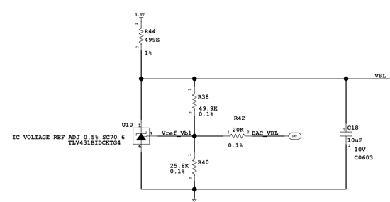

We design a voltage reference circuit with the TLV431 as
in the follow diagram:

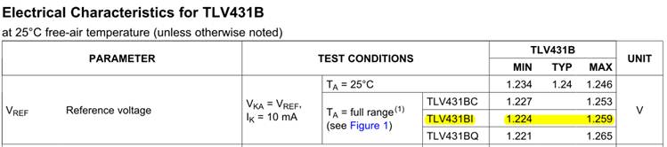

While maintain DAC_VBL to the minimum tolerance, the TLV431BI induce large error for our implementation
Can you please suggest  a more accurate shunt with same/samaller package?
