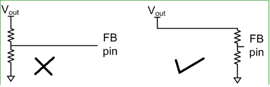

I am wondering if it is acceptable to have the RFBT resistor connect to Vout near the load, rather than near pin 7, to account for voltage drop between the regulator and the load.
In particular I have a current sense resistor of 10 milli-ohms between the LMZ12003EXT and the load, and while the voltage drop across that should be acceptable, I would prefer to have the voltage regulated at the load.
