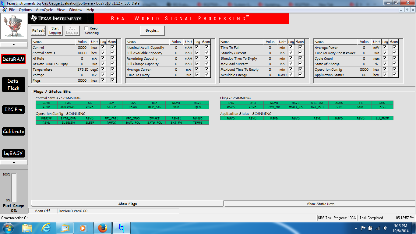

    Can you please post a screenshot of your EVSW showing the DataRAM screen after you click Refresh?
  • Here you have the screenshot of the DataRAM screen after I click Refresh. You can see that all values are empty. But not the temperature
    Javier
  • Hi Javier,
    Your screenshot is showing that all data is 0, including temperature which is converted from Kelvin to Celsius and is also showing 0K.  Also, at the bottom of the window you can see Device 0 Ver 0.00 which shows us that when you started EVSW, it tried to read the device type and FW version from the gauge but zeros were returned.  That could be because your SDA line is held low (or not pulled up, perhaps) or because the gauge is in ROM mode and not running FW.
    Is this on an EVM or on your PCB?
    Go to the I2C Pro screen and click the Execute FW button, then come back to DataRAM and try to Refresh.

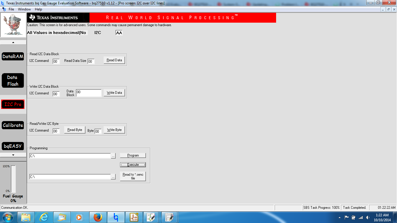

    Regarding the I2C Pro screen I couldn't click today in the execute FW button because I wasn't in the office. I will do it next day. But I attach a screenshot of how this screen is in my EVSW. You can see that everything is 0 or empty.
    As you see I didn't modify nothing. Should I modify these valors?
