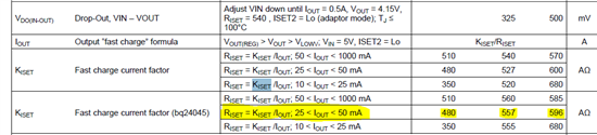

Can BQ24045 have any issue on the charging current on 30mA. Can you kindly advise?
Based on datasheet page 7, it should not be issue.
But base on page 5 & page 18, it only indicate the RISET can up to 10.8kohm, which is 50mA only.

    BQ24045 can support fast charge current at 30mA using a resistor above what is recommended on datasheet.However, we only guarantee the termination current accuracy down to 6mA for this device. Therefore, if you charge at 30mA, it is not recommended to set the termination percentage lower than 20%.
