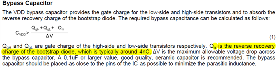

Our customer is studying about calculation method of the Bootstrap Capacitor.
Please let me ask the following question.
[Q1]
Could you please let me know the calculation method of the ton and ⊿V?
I couldn't find the calculation formula.
[Q2]
Could you please let me know the value of QgH?
I can find the Qrr=4nC but I couldn’t find the value of QgH.
[Q3]
Why will IHB (the quiescent current of the high-side driver) be used?
I’m thinking that this parameter is IHBO (Total HB Operating Current).
If my thoughts are different, could you please let us know the reason why you use the IHB for?
