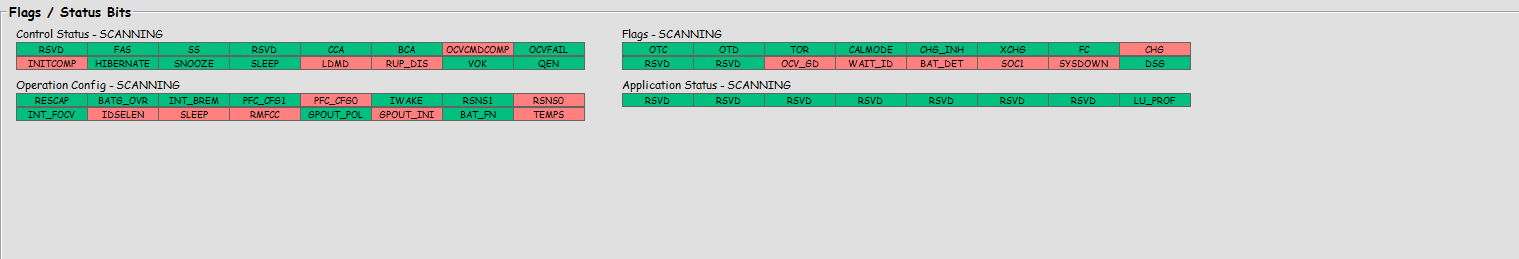

These were BQ27510-G3 flags.( factory output )
I already enter Unseal and Full-access mode.
except bqEasy..
but I can't write flash parameter. I want to know other command for unlocked the falsh.
how should I do?

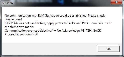

I am using the EV2300 and the BQ27510-G2.
I see that both lines SDA and SCL are kept down of the I2C communication and I have connected these lines with pull-up resistors so in the bqEVSW "communication error" is shown. Any idea why they are kept down? it is suppose that both lines should be up right?.
Thanks in advance

A collegue of me used the same set up before and it worked (the same bq27510-G2, EV2300 and bqEVSW) so the schematic is correct.
The thing is that when I open the bqEVSW even if I select 1.22 or 1.23 an screen is shown with the following error:
This error appears because both lines, SDA and SCL are kept down. I have replaced the BQ27510-G2 several times so it is not possible that it is broken. I want to make a golden image but first I need to get "communication ok". In SDA and SCL is connected the BQ27510 and EV2300 only.
Any another idea why SDA and SCL are not up?
Thanks for your reply
Javier

I already checked if there are any short circuit in the PCB and in both lines and I didn't find any short circuit.
Did you modify something in the I2C Pro screen? I have it per default
Could you tell me what voltage do you have in the lines SDA and SCL?
Javier

My fuel gauge detects the battery and in the pin "REG25" there is 3V. So the fuel gauge is powered up.
To make sure that my EV2300 is working well, I would like to know what voltage you have in the I2C output of the EV2300 when it is not connected to the target.
Javier
There is no voltage output on SDA/SCL lines of the EV2300. You must use external pullups to hold these lines high.
The EV2400 does have built-in pullups on SDA/SCL, so it is best to disable any external pullups if you use that box.
ok and in VOUT of the EV2300 there should be 5V right? because I don't have voltage in VOUT
Javier

Hi
I already found the issue. The 10Kohm pull-up resistors of the SDA and SCL lines
were broken. The strange is how these resistors got broken.
