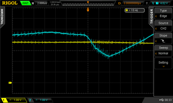

    I added some code to my test-bench today that would trigger the watchdog reset every 10secs to ensure no timeouts were occurring. I also checked several nodes with the oscilloscope and found the source of the register(s) resetting -  Whenever I enable the BQ24250 with functional parameters (VDPM 4.2V, Not HIZ) the inrush current on the IN pin seems to crash the boost regulator U4 (shown in my schematic above).

    As can be seen above (and similar experiments), the moment the BQ24250 is taken out of the HIZ mode, the registers are reset. Monitoring IN (pin 19) we see this sudden drop exactly occurring as the device is set to 100mA input mode.
    CH1 is Vsystem (stable), CH2 is the output of the boost converter and the input to the BQ24250 (unstable when taken out of HIZ mode)
