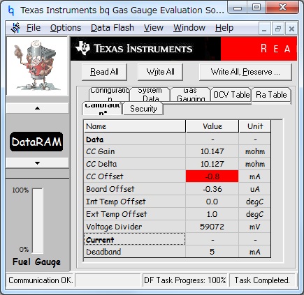

With reference to the slua665, I have been trying to make the DFI file for mass production. So, Using the Data Flash tab of bqEVSW(EV2400), I am trying to write the configuration to bq34z100 EVM.
I have a problem about the operations that have been written of P.4 of slua665 as "Write the average calibration values to the optimized working sample board.".
Sometimes, the calibration of the CC offset can not be written. Other items in the calibration tab is similar, but does not occur on an item in the configuration tab.
Please teach me this problem occurs in what cause, or a workaround for this problem.
thank you. (Please tell me if there is missing information. I will prepared to rush it.)
Postscript:
I was able calibration Int Int/Ext Temp Offset, Voltage Devider, and Deadband by Data Flash tab. And When I changed CC Gain or CC Delta, the value cell became red, but I can be seen that written by pushing "Read All" button.
So, I can not modify CC offset calibration only.
