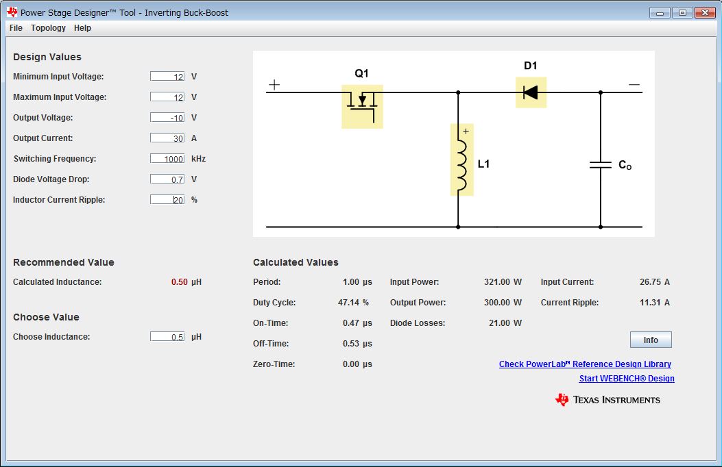

Our customer request the following specification inverging buck-boost.
Could you please let me know the recommend DCDC and FET for the following requirement?
Vin:12V
Vout : -10.5V
Iout: 30A
I found the PMP8928 which is 65W inverging buck-boost reference design as maximum output power in PowerLab.
> http://www.ti.com/tool/PMP8928
If we can't achieve above requirement , please let me know the problem.( inductor or diode ?)
Also I simulated these requirement by Power Stage designer.
As a result, we need the inductor about 0.5uH/63A. I think that this value is
Ryuji Asaka
  • Ryuji,
    I would consider a 2-phase buck controller for 30A output (15A per phase).  LM25119 reference designs are a good place to start.   See the link below for a 20A design that could be stretched to 30A with adjustments to current sense resistor, inductors and possilby the FETs.
       http://www.ti.com/tool/pmp7428
  • Hi Ryuji
    One of LM5119 reference design can deliver 30A. Please refer the schematic at http://www.ti.com/tool/pmp7990.

    According to Power Stage Designer , FET / Diode current is the following. (ripple current is 25%)
    FET: Max Current 21.75A, RMS current : 13.47A
    Diode : Max Current 21.75A, RMS current :  13.94A ,Diode Losses 7W
    I think that there are the FET/Diode for above current. Are there any concerning without current , powe rlosses?
