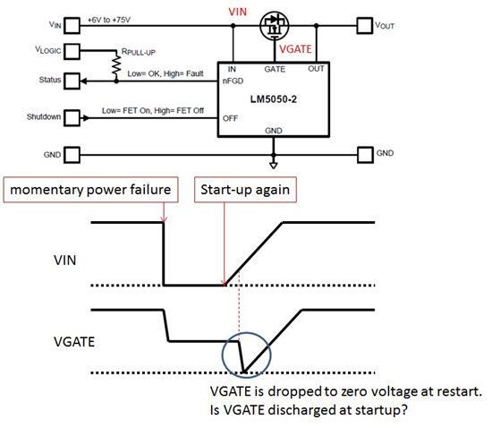

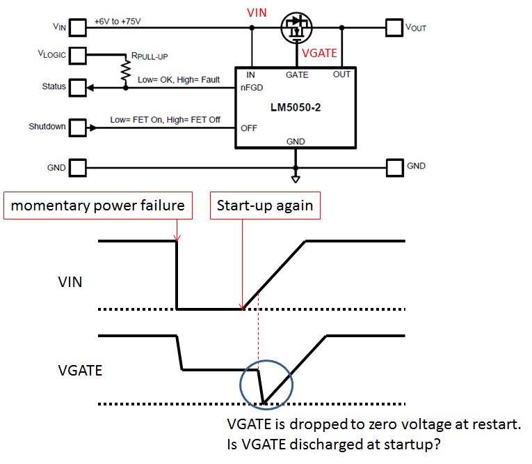

Hi All,
Our customer has evaluated LM5050-2 at momentary power failure and then they confirmed the VGATE is not fully discharged. I believe that this is due to the device is stopped before fully discharging VGATE. Next they confirmed the VGAET is dropped to zero voltage at restart timing. Does this mean that the LM5050-2 discharged VGATE at start-up first and then start to regulate FET?

  • Sonoki- san,
     When  the input power fails abruptly... as your case is , the MOSFET current reverses from Vout to Vin ,  Now the  voltage across the LM5050-2 IN and OUT pins is more negative than the VSD(REV) voltage of -27 mV (typical), the LM5050-2 will quickly discharge the MOSFET gate through a strong GATE to IN pin discharge transistor.
     So after power fails, VGate will be discharged as explained above and at every start up   it will  regulate the MOSFET gate-to-source voltage if the voltage across the MOSFET source and drain pins falls below the VSD(REG) voltage of 27 mV (typical).
    Let me know if you have further question.
    Dinesh
  • Dinesh-san,
    Thank you for your response. Now I'm assuming that the VIN fall to 0V quickly then the MOSFET gate can not be fully discharged and the gate voltage is remained. But you also commented that that the gate will be discharged at every start up, so I understand that the remaining charge at gate is discharged at every start up.
    Is my understanding correct?
