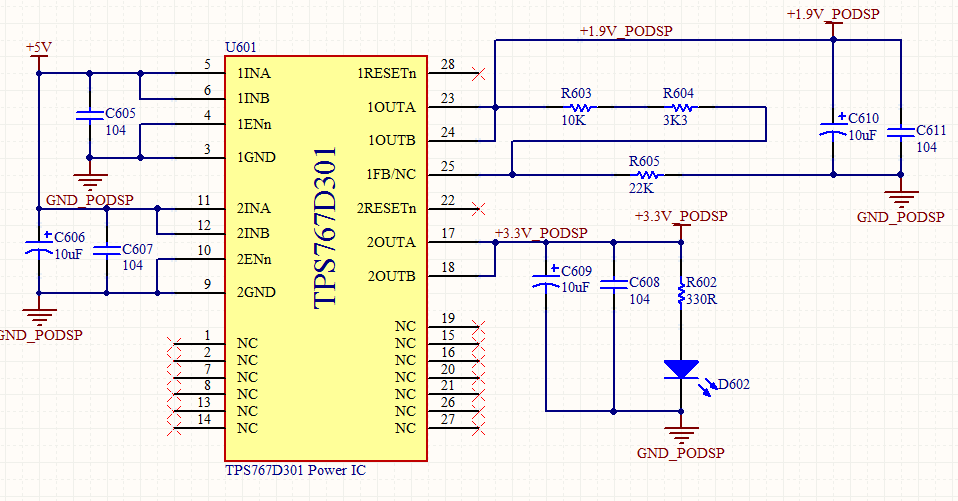

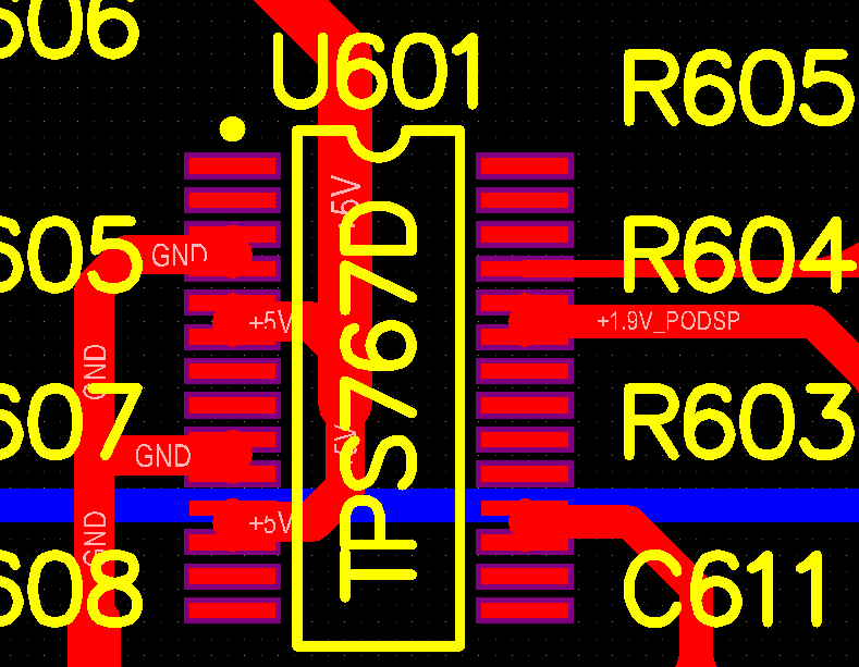

  • TPS767D301 increat temparature high!
    Dear All,
    We designed a power schematic for DSP as TPS767D301. Voltage output at Vout1 = 1.89 V, Vout2 = 3.3V. But after about 15s, IC TPS767D301 increate temparature than 70 C. I have up image of schematic and PCB folow url :
    www.upsieutoc.com/.../DJR3 (PCB)
    www.upsieutoc.com/.../DJRA (Schematic)
    Can you help me reson increate temparature of TPS767D301? I don't see my design other with datasheet of TPS767D301. Thanks many!

  • Dear Mark Sellers,
      Thank you for your reply, I insert again my schematic and PCB. Can you help me?
  • I check again datasheet of TPS767D301, but i don't see problem in my schematic. Haizz, may be by quality of IC. :(
  • Hi Achut,
    Ater looking at your layout and schematic I did notice that you did not connect the thermal pad on the bottom of the device. This will be important to dissipate heat by using the PCB as a heat sink for the LDO. The thermal specs that are listed in the datasheet are only valid for having the thermal pad connected as specified in the datasheet. One more thing to consider is you have 5V as the supply voltage to the device, depending on the current that the LDO is providing it is not unreasonable to see this kind of heating especially without the thernal pad connected. One way to reduce the amount of power that is being dissipated across the device is to reduce the headroom that you have by lowering the input voltage. If the input voltages are adjusted be sure to ensure that all of the requirements in the Electrical Characteristics table on page 3 are met for proper device functionality.
