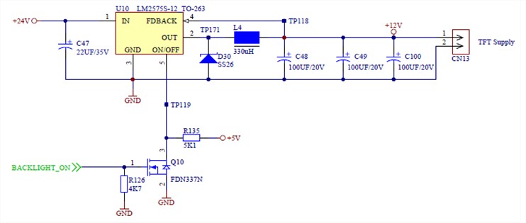

We have the following design:
LM2575-12 fixed output buck converter with regulated 24V input
Input capacitor: 22uF 35V tantalum
Ouput capacitor: 3x 100uF 20V tantalum
Inductor: 330uH
We have few boards where one of the output capacitor burns out after 1min where 24V input is applied for the first time (without load). Any idea about possible root cause ?

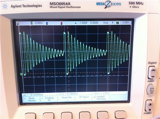

    Without load, at pin 2 of LM2575, I can observe the following signal:
    Here's the schematics
  • I could be that The ESR of the caps is too high.  The ripple current may be overheating the cap.
    Try a diffierent cap with lower ESR or a 10-20uF ceramic in parallel.

  • Thanks for your comments.
    To Frank: The 3 capacitors used are given with a max ripple of 0.5Arms@100Khz (max ESR = 0.6ohm), it looks good for me regarding measured ripple ?
    To Marc: The fact is that 95% of failures happen the first time the board is powered for firmware loading after flying probe testing and the load is not yet connected.
    Any comments about the oscillation at pin 2 without load ? This oscillation is not observed when the load is connected (500mA for LED supply of TFT screen)
    Nick
  • The ringing on the switch pin is normal for no load operation.  When the power switch is off and the diode current drops to zero, the switch node becomes high impedance and that node rings with the inductor and parasitic capacitance at that node.
