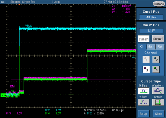

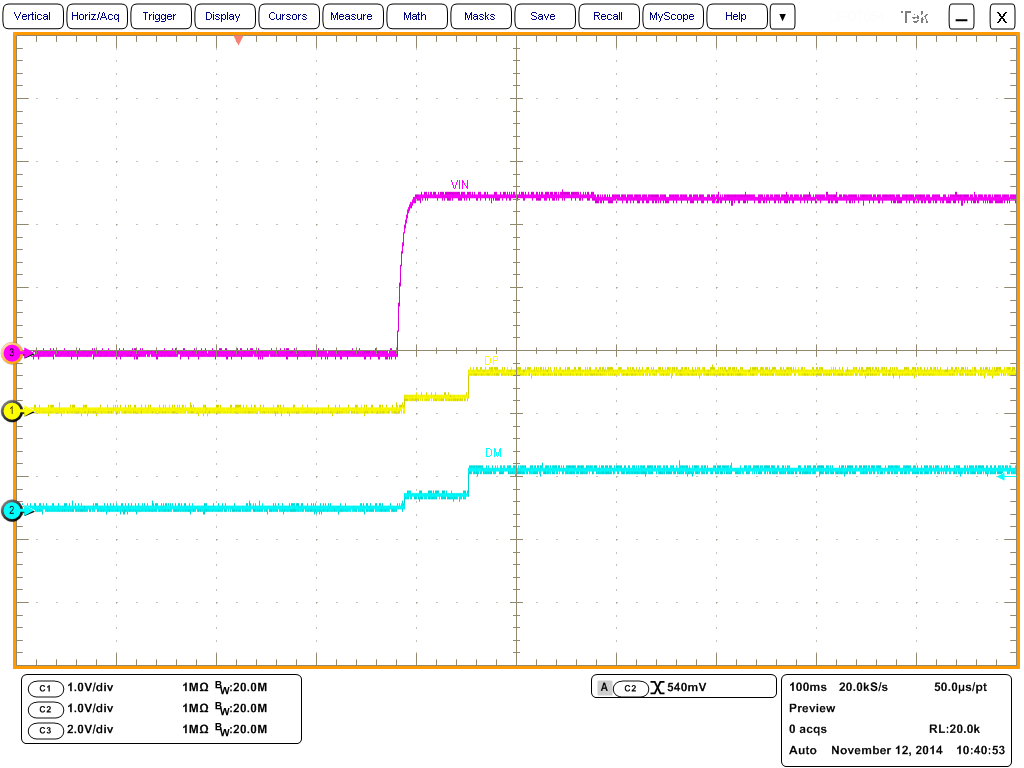

  • Hi Wenjia,
    Thanks for the explanation. I have 2 screenshots that show when the BQ is able to detect DCP and the fail detection.
    The First image is where the detecttion fails
    The second image is a pass detection
    Can you point out the critical region that determine the failure or success of the detection? According to the datasheet, the DP DM lines must be below 0.9v to be successful.
  • Hello Suzanne,
    When you say DCP detection failed, did the IC detect SDP or CDP? In the primary detection, the IC will detect if the port is SDP or one of DCP and CDP and if it detects DCP/CDP, it will continue to determine if it's DCP or CDP in the secondary detection.
    More specifically, during the primary detection, the IC will source a voltage on DP pin (VDP_SRC) and then compare the DM voltage with a reference VDAT_REF which is 0.4V maximum according to the BC 1.2 spec. If the DM voltage is above this reference, then the IC will detect DCP/CDP. Then during the secondary detection, the IC will source a voltage on DM pin instead (VDM_SRC) and compare the DP voltage with VDAT_REF. If DP voltage is close to DM voltage, then it is DCP as DM and DP should be shorted in DCP, while if DP voltage is close to zero, then it is detected as CDP.

  • Hi Wenjia,
    When I say fail detection, i meant instead of detecting a DCP; BQ is detecting SDP.
    Will the detection be affected by Hi-Z mode of the BQ IC? As what we have seen from the 1st image (fail detection) on the last post, the pulse is caused by enabling the Hi-Z mode of the BQ IC. Is this the expected behavior? However, i do not understand the different behavior from the 2 images. The 2 images are captured with the same firmware where the Hi-Z is enabled on initialization.We can see the pulse at a percentage of 60%
    As of now, by disabling Hi-Z, we can detect DCP or any other port type successfully and the signal waveform is different ( please see the attached imae). We would like to know if this is the root cause of the failure.
  • Hi Suzanne,
    I tried this on the bq24251 EVM. When the DCP port is plugged in regularly, the DP and DM signals are shown below.
    When the DCP port is plugged in with HIZ enabled.
    You can see that if Hiz is enabled, the DM and DP remained to zero. As is described in my previous reply, when the IC is doing the primary detection, the voltage at DM is compared with a reference which is ~0.4V. If DM voltage is above the reference, the IC will detect DCP/CDP, unless it will be SDP. Therefore, as DM and DP are both close to zero in the above plot, the IC detects SDP instead. I'm not sure why your plots are different than mine, but my guess would be the voltage drop at the beginning of your fail detection plot is the reason for false detection.
    Wenjia
