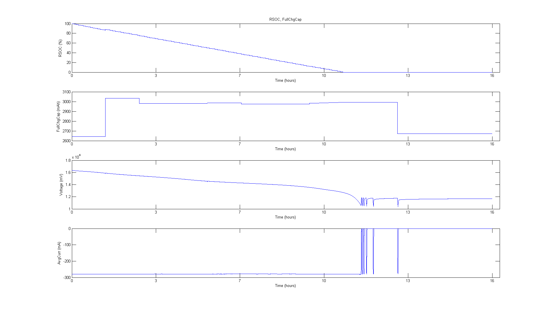

FullChargeCapacity Changes
I'm having trouble with a 4 cell pack based around the bq20z95.  Specifically, the FullChargeCapacity figure won't seem to settle.  We have tested the cells with a battery analyser and found that the capacity is a little lower than stated in the datasheet - 3.1Ah (@3A down to 2.5V, vs. 3.35Ah), but I'm more concerned that the FCC value produced by the gauge won't seem to settle.  Our application draws just under 300mA, so I would thought we would settle on around 3Ah.
As shown in the attached bmp, the FCC value does hit 3Ah for most of the discharge cycle, but after a full discharge, it seems to fall back 2.65Ah during relaxation.
Any suggestions on why this may be happening will be appreciated.  Perhaps I need to repeat the learning cycle?
Thank you,
Jeremy.

  • I see a number of issue you might want to look at
    1) you have CUV and PUV set to 2500/cell and you have VTERM set to 10000.  Once CUV occurs after 2s CUV time the FETS switch off and switch off the load . You have CUV recovery set to 3000/cell so it looks like FETs turn on again when pack recovers to 12000 and then load drags cell down again so it turns off, keep repeating . You need to lower the CUV and PUV setting . At the moment the load is pulsing on and off when discharge is reached. Pulsing can creating gauging and FCC difficulties especially near Vterm.
    2) I see you have load mode 1 and load select 1. If this is a constant load current application I would recommend load mode 0 constant current instead as which might make FCC more stable
    3) you have load select 1 , so that is present averge load power , or current if you change to load mode 0. It looks like you did the original learning at 2A (2023mA/2287mW) accoriding to GG file "average I last cycle" and this value has never updated on subsequent cycles. I suspect it never updated because it updates at end of cycle in relax and with your CUV issue it may have been prevented to update properly. But these large values are adversely affecting the simulation at start of charge since it uses these figures until it does next FCC update  at first grid point around 89% SOC. If these large figures don't correct themselves after a few more cycles once you fixed the CUV issue and let the pack relax properly at VTERM then I would edit them down by a factor of 10 or so closer to your intended load.
    Can you attache the log for  plots as I wanted to check some of the other figures when FCC jumps down near the end.
    In your testing you maybe need to look at how you are turning off the load current rather than rely on CUV action.
  • Mike,
    I'll edit the cut-outs as you suggest and do some more cycles.  Our application is actually constant power, I'm just using a constant current load for testing purposes.  I have attached the log file too.
    Thank you,
    Jeremy.

  • I'll leave the safety cut-outs as they are, but I'll increase the DepletedVoltage to 10500mV and DepletedRecovery to 13500mV, which is well above the maximum relaxation (following discharge to 10000mV) voltage of around 11800mV.  I'll increase DepletedRecovery further if discharging to only 10500mV allows significantly higher relaxation voltage.
  • Pay attention to Vterm as well with respect to CUV. If the part cuts off the load at VTERM then it may affect how it gauges properlt to VTERM . ie VTERM is where it wants to set SOC =0% but if it cuts off as soon as it gets there how can it properly learn that 0% point?
  • Mike,
    Did you get a chance to look at the log file?  I've adjusted the Term Voltage to 12000mV, Depleted Voltage to 11000mV and Depleted Recovery to 14000mV and set CS_XCHGLV so that the DSG Fet opens when the pack is discharged to the Depleted Voltage.  Even with hours of relaxation after full discharge, the pack voltage does not exceed 1400mV, so the oscillation seen previously has been eliminated.
    With the new settings, everything appeared to be working as expected on discharge.  However, after 2 hours of relaxation following a full charge, the Full Charge Capacity jumped down again.  I also noticed that the Avg I Last Run remains at 2023mA, despite use of a 280mA discharge current.
    Perhaps I should repeat the learning cycle?

  • Jeremy,
    Can you run a discharge cycle at >C/10, where C is your design capacity. So I see the design capacity is 3350 , which means you want to try a discharge current >335mA compared to the 280mA you are using. Let me know if that causes Average current last cycle to update.I think that value is also linked to the resistance table update process but that only runs for >C/10 discharge
    thanks
    Mike
  • One other thing , apart from increasing discharge current to >335mA , could you also set the EVSW to export a GG file at say every 5 minute interval, I would like to be able to look at the GG file after the FCC change during relax to see if Qmax updated, asI suspect that is what triggered the FCC update
  • Mike,
    I'll try again at a higher discharge rate, but it does say: "The exact rate is not critical" on page 2 of SLUA379D.
    Also, if the discharge rate needs to exceed C/5 for an update, does that mean that the gauge won't update in future as our application draws <C/5?
    Jeremy.
  • Hi Jeremy,
    the min discharge rate for updating Ra tables is C/10 but unfortunately that is not really well captured in any app note. I am hoping that also will trigger update of average current last cycle. The only other factor in updating average current last cycle is relaxing sufficiently after the discharge.
    I note that your test current of 280mA is about C/12. Does that represent the load current you will see in practice?
    Mike
  • Mike,
    Our application draws constant power, but I am approximating the discharge with a constant current of 280mA, around C/12.  I repeated the discharge with a 500mA load, around C/7 to trigger update of the Avg I Last Run, but unfortunately, it is still stuck on 2023mA.  Will the algorithm continue to 'relearn' throughout the life of the pack, or is there a limit to the number of times?
    I have attached a log file and gg files collected every 5 minutes - the pack was relaxed over 5 hours after full charge and over 12 hours following discharge.
    Perhaps it's time to start from scratch again?

  • I was just looking at the gg files and see that you did not get a Qmax update either , although it looked like you had had a valid OCV for Qmax  in the previous relax which you said was for 5 hours. I see the cycle count increment from 8 to 9 on this discharge, and comparing also to the earlier gg you posted last week I saw that was taken on cycle 5 . When did you make the changes to the FLASH settings, ie what cycle,  and did you give the pack a reset after you had done so ?
    I see that the Qmax updated between cycle 5 and cycle 8. I see that FCC changed from 2468 to 2465 at the start of  his cycle but then remained fixed. hence I asked if you sent a reset after the changes as I am wondering if the gauge is running correctly ?
    Did the pack sit for an exentended relax over last weekend but then how was the previous relax for just 5 hours only
    What CHEM ID is this battery ?
    Note  I am wondering if you are in Australia as the time stamp on the log is 11/11. I suspect  I spoke to you at the Dallas Deep Dive BMS seminar two weeks ago?
  • Mike,
    I checked the CHEM ID and discovered that I had inadvertently contaminated my Golden File with the wrong Chemistry File!  I have corrected this to CHEM ID 2012, issued a reset and done two cycles using a 500mA constant current load.  The FCC is less erratic now for the electronic load, but I am now in the process of doing a couple of cycles with the actual load, which draws around 280mA.  After the first discharge, the FCC climbed to 2947mAh, but of course, the Avg I Last Run now remains at 500mA.  Earlier in this thread you mentioned that this variable feeds into the FCC calculation.  This suggests that full gauge accuracy can only be achieved if the application draws more than C/10.  Is this correct?  Perhaps I should manually overwrite the Avg I Last Run with 280mA?
    You are correct - I'm in Australia, but unfortunately, I did not make it along to the seminar you mentioned.

  • Jeremy,
    the average current last cycle should update at the end of every cycle assuming you stop and relax for a brief moment  after discharge ends.  In some learning logs of my own I noted that it was changing almost imediately I stopped discharging.
    I am not 100% certain what happens if you dicharge at a current less than C/10, i.e. whether it still updates.
    Yes you could just edit the average current last cycle values to be what you want for a test, but obviously they should change again after next cycle.
    If C/10 is an issue let me know , we might be able to tweak it to C/12 if that would be better.
    Load mode and load select values determine what power/current load the FCC calculation is using to predict when V Term will be reached during discharge. If you use a load select setting that is looking at the current cycle then when you first start to discharge it obviously does not have a current cycle value to use so it uses the last cycle. So if the last cycle value is higher than actual then FCC maybe get initially estimatedslightly  lower sinec IR drops will terminate discharge at Vterm sooner. However at the first grid point when FCC is updated again assuming the gauge is still discharging , and depending on your load select setting, it will start using load rate data from the current cycle.
