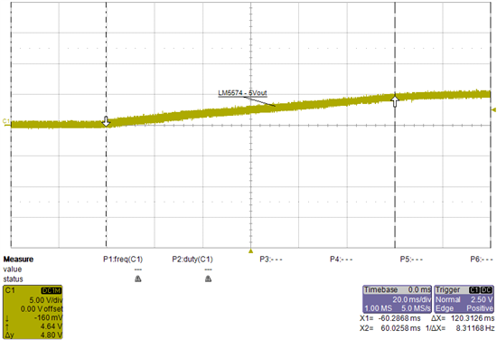

Is there soft start capacitance limitation for LM5574/5?
If there is, please let me know the maximum capacitance value.

Ryuji-san,
It seems like you have a specialized application. What soft start time are you targeting and what capacitor value are you looking at? This will help us figure this out faster.
Anston
Ryuji san,

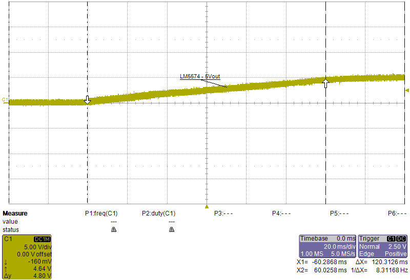

I tested an LM5574 on a stock eval board with a 1uF SS capacitor at 25C with an input voltage of 18V and output of 5V under no load. The soft start time was 120msecs and there were no issues during startup. I've attached the scope shot showing this. I can only confirm that this works for the conditions mentioned. Hope this is sufficient.
