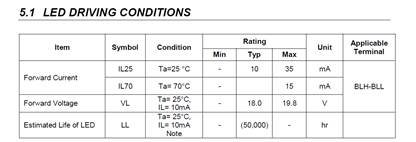

Using today the TPS61042 as an LCD BACKLIHHT driver ,but will change the display with lower operating voltage of 18V. The new display LED DRIVER requirements:
Is the TPS61042 still can be used?
Do we have other solution that can support VIN>12V?
