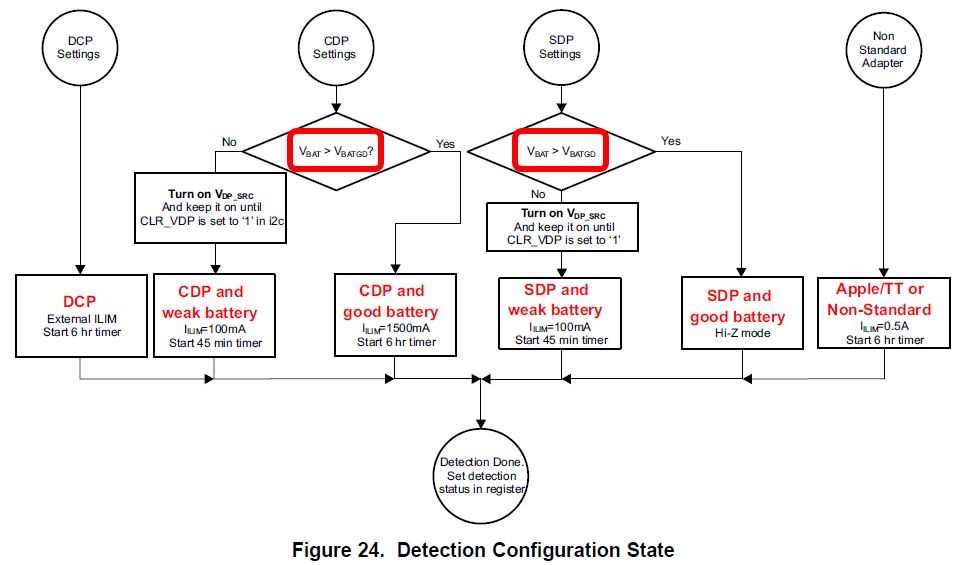

I have a question for bq24251.
The VBATGD threshold is used for D+/D- detection however there is no information of VBATGD in datasheet. Please let me know which parameter should be referred.
Sonoki / Japan Disty
Hello Satoshi-san,
VBAT_GD is 3.4V for bq24251 and it was not stated in the datasheet.
Wenjia
Hi Satoshi-san,
VBATGD is not a parameter that we test in the production test, so we don't have a spec of it. However, it is the same parameter as what you showed for bq24196.
Wenjia
