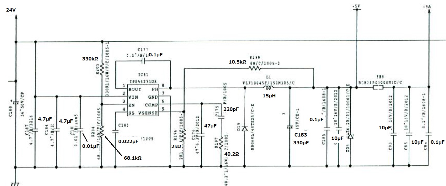

About Css of TPS54231, a datasheet has the following statements.
"The slow-start time should be set between 1 ms to 10 ms to ensure good startup behavior. The value of the
slow-start capacitor should not exceed 27 nF."
If a larger capacitor (more than 27nF) is connected, what kind of problem?

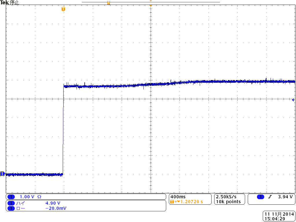

As shown in the following, does it come to take time until it becomes "Vout x 100%"?
※A circuit diagram and the expanded waveform are under requesting.
 (Vin:24V / Vout:5V / Iout:1A)
