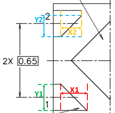

Hi Team,
Could you please let us know the accurate package dimensions(X1 and Y1 (PIN1) , X2 and Y2(PIN2,3,4))?
Our customer needs this information to design it.
<package dimensions>
X1 = ??mm +/- ??mm
X2 = ??mm +/- ??mm
Y1 = ??mm +/- ??mm
Y2 = ??mm +/- ??mm
I’d greatly appreciate your verification.

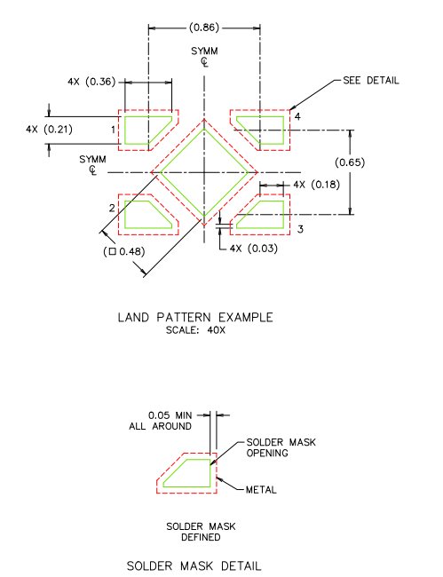

  • I am not a package expert, but it seems to me that the existing X2SON Solder Mask Detail page should provide enough detail to determine the dimensions being requested.
  • As Don has responded, the recommended footprint has been developed and tested to properly balance the solder with the package, as well as do eliminate the acute corner that pin 1 would require by making all pads the same. It is recommended that customers do not deviate from the land pattern example above.
    SolderMask Defined (SMD) pad definition is recommended so that PCB trace connections do not disturb the requirements for proper balanced assembly. There should be no need to define a different type of footprint.
