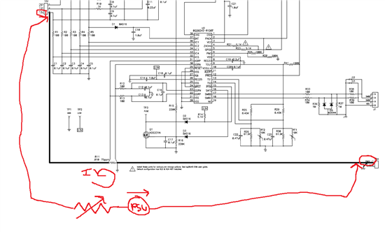

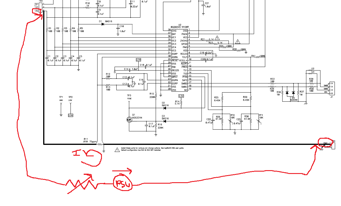

    the objective of the power supply and electronic load connected around the sense resistor is to just pass current through the sense resistor and not through the power supply biasing up the stack.  So connect your supply and load across the Pack -  and 1N terminal so that the current only flows along the gnd line through the sense resistor. You will have to change the orientation of the connections to suit the current direction you want to simulate charge or discharging

  • I attached a sketch. yes the sense resistor goes to ASRN and ASRP ( but is actually sensed for measurement by GSRN and GSRP), so Pack- is effectively connected to ASRN , and the 1N terminal which is ground of the lowest cell on EVM connects to ASRP. So If you attach a series supply and current limiting load across these points you can flow a current in either direction through the sense resistor to create different test charg/discharge current.
